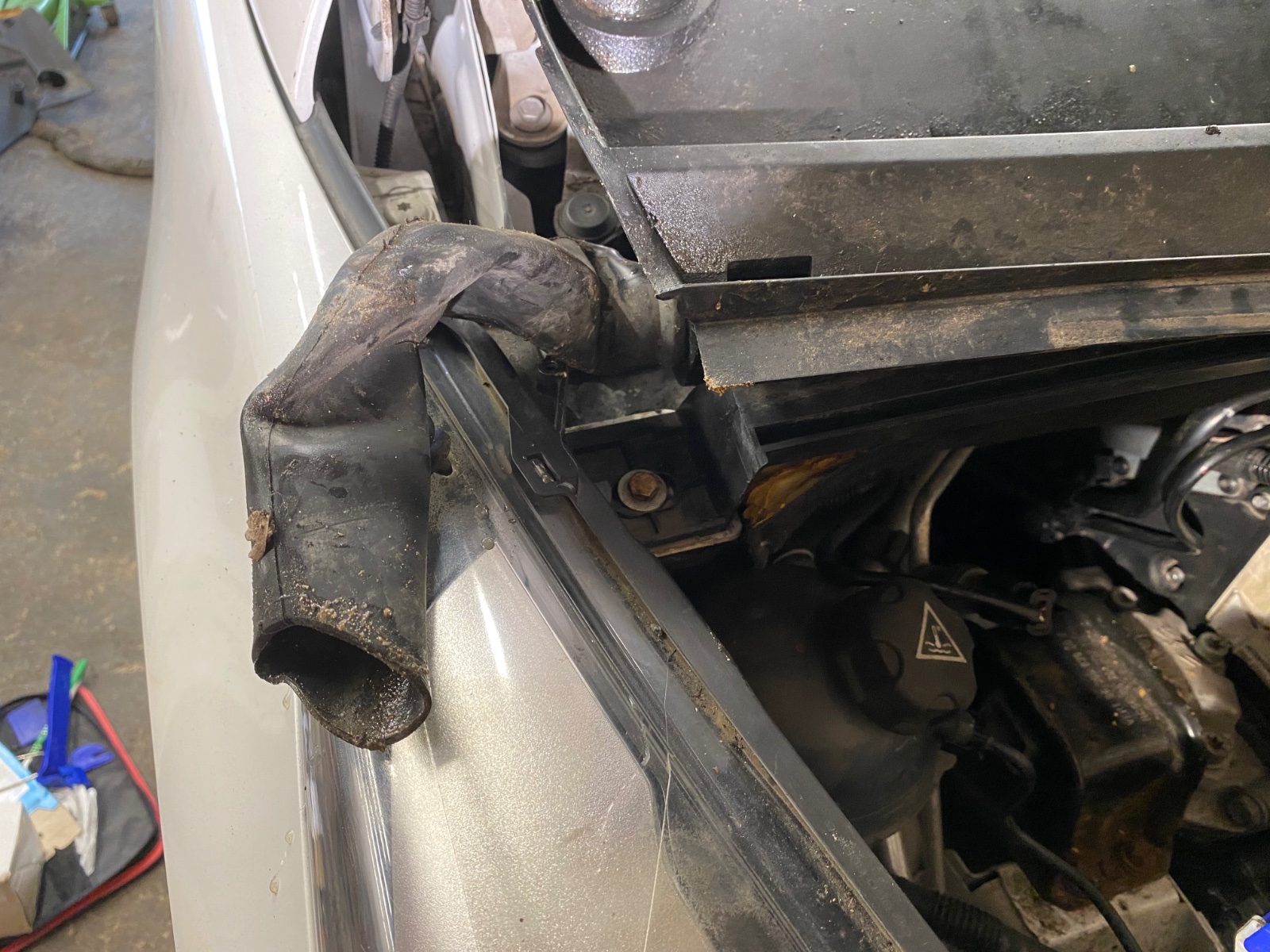

Getting the pollen filters out was the easy bit. Getting the new ones back is was a nightmare. Mine is slightly different to that. There is no slide rail.
On the scuttle, there are two rubbers drainage tubes which look as though they should discharge above the wheel arch liner but you cannot actually see the route from inside the engine bay.
The tube on the offside has a connector for connecting it to a fixed point. The near side doesn’t and seems shorter than the offside one.

Yes those tubes are different on mine, as long as they are shoved down the edge to direct water into the wheel arch well they are OK.

RichardW wrote: 07 Sep 2024, 20:03 Yes those tubes are different on mine, as long as they are shoved down the edge to direct water into the wheel arch well they are OK.
I think they have to direct water over the top of the wheel arch liner. Not a brilliant design - water being held in certain areas by capillary action when the wheel arch liner touches the outerwing and no doubt parts of the inner wing too where the plastic connectors hold the arch liner. I think to have any chance of directing those tubes properly, one would have to remove the headlights so you can get in and clip them into place. Very fiddly
