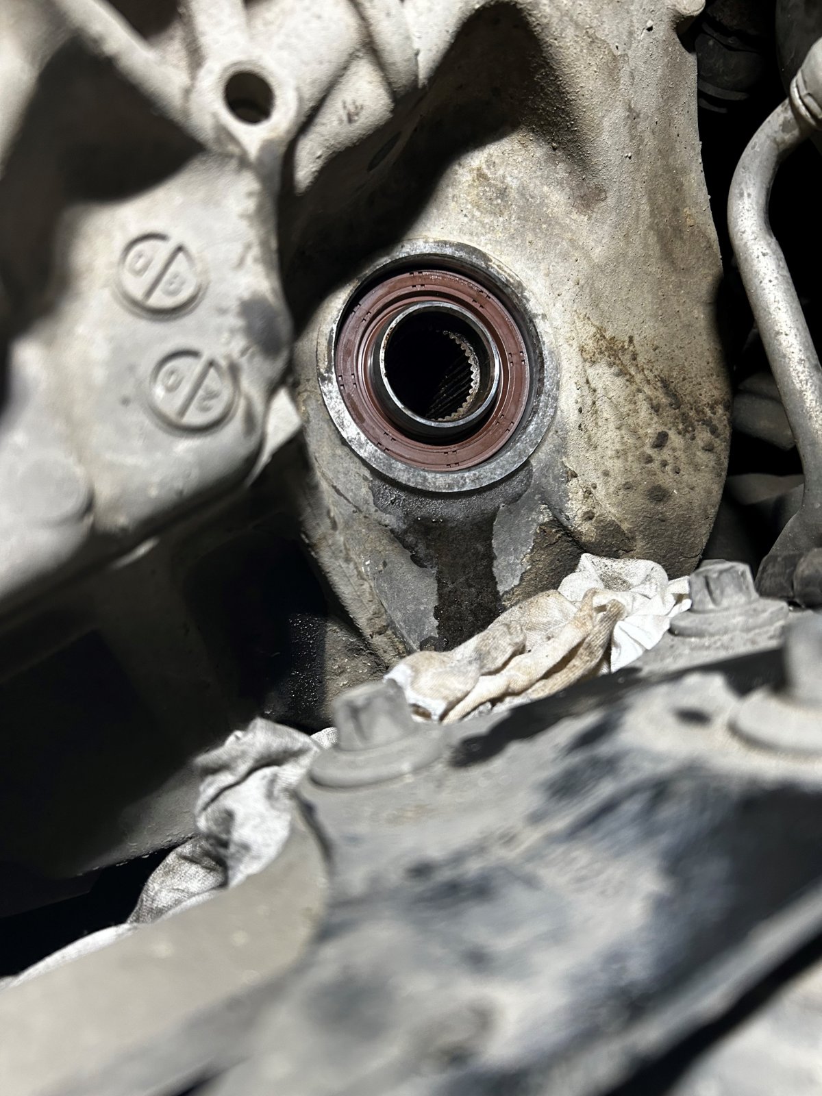

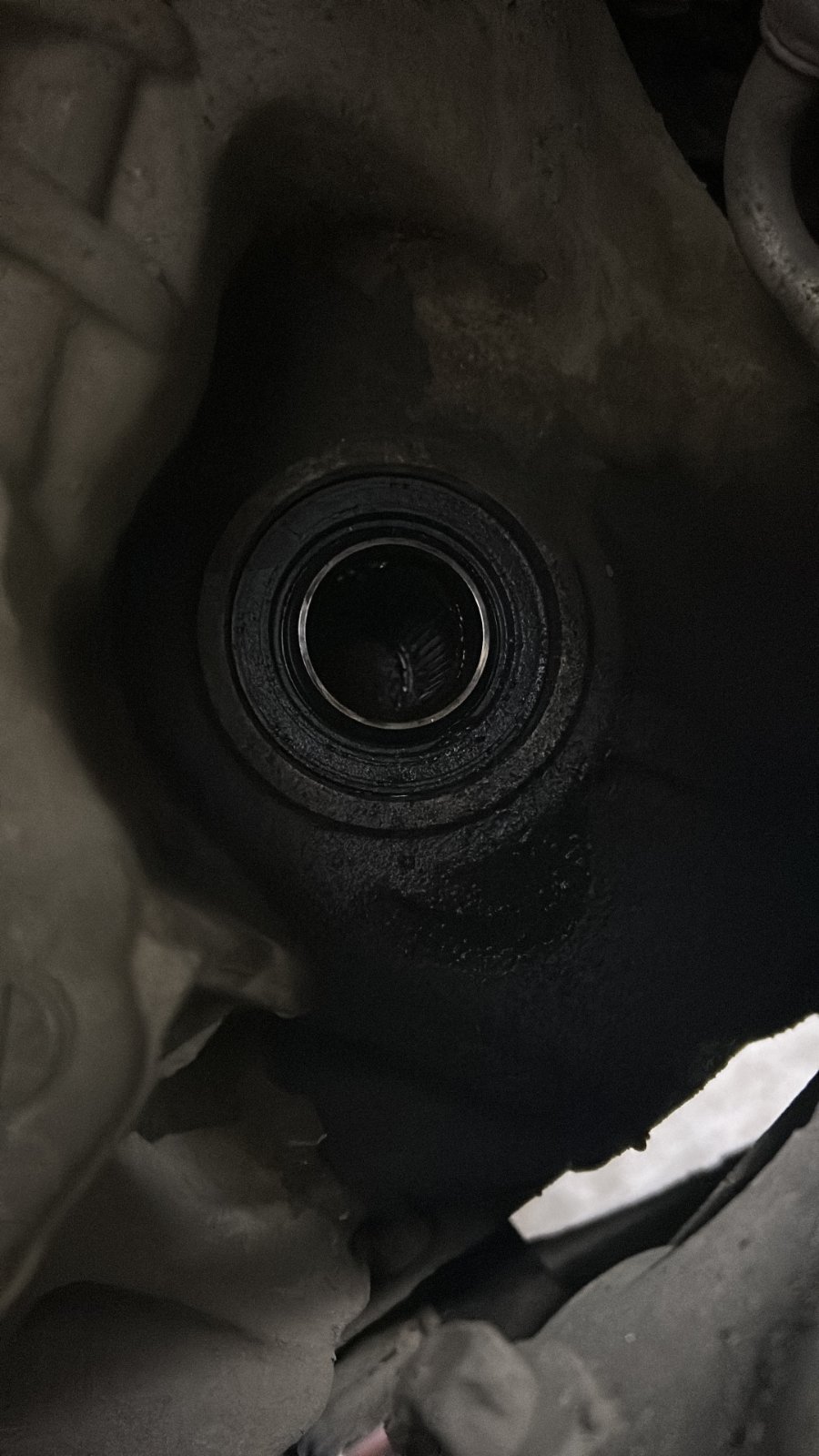

Dear colleagues, I was trying to find a post in regards to the axel shaft sealing for automatic gearbox Aisin AM6, but not successfully. May I ask if somebody of you has the procedure of axle shaft sealing replacement, for the left one (short axle shaft)? I have replaced the sealing 6 months ago and after a few days I have observed oil back leaking on the gearbox housing, under the shaft. I need to mention that I have pressed that new sealing as the old one was.
So last Friday I have replaced the sealing again and pressed the sealing more - maybe too much, that's why I need to check for leakage. I can attach a photo of the old sealing and the new one (red). Many thanks.
