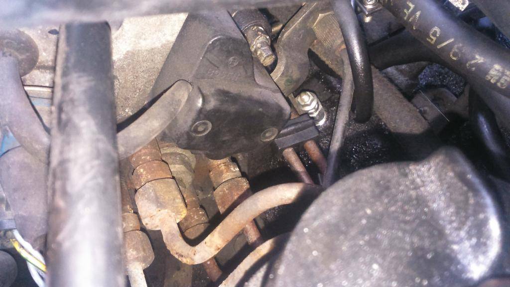

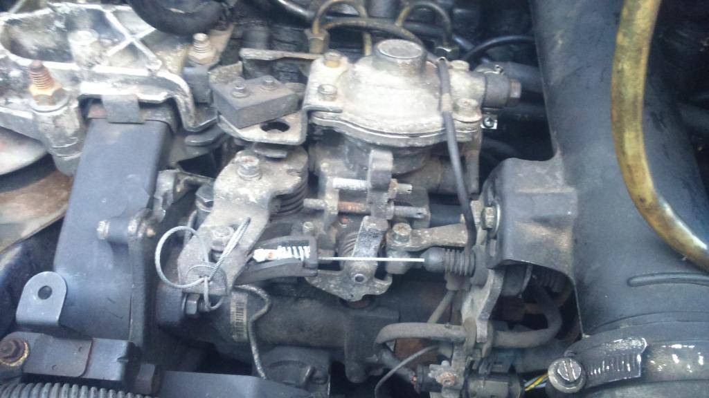

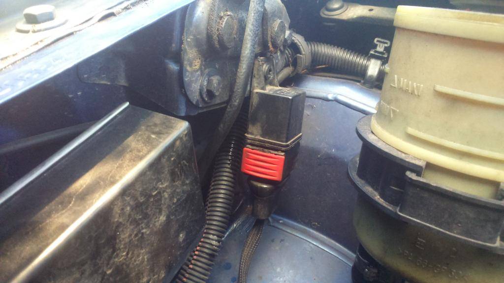

Trying again with the pictures. One of the suspected plug and socket connectors, one of the little black box on the pump and the last one is just a general view of the pump from the front.
Can anyone tell me what any of these do and if I can bypass this system please?

OK, you can all stop laughing now. What I thought was a stop solenoid, and what I changed a couple of years ago, is in fact a timing solenoid. Anyway, she's running again now. The guy at the garage wouldn't touch the injector pump but he was happy for my brother and I to tinker with it while it was in his car park.
We managed to remove the anti theft and immobiliser gubbins, and the anti theft bolts holding it all on. Then we ran a switched positive from the glow plug relay to the, now uncovered, solenoid. We did try to run a switched live from the lead that fed the immobiliser but for some reason, it just wouldn't work.

is the stop solenoid showing in any of those picys, as i can see it #-o :-D :wink:
there is a switched 12V live feed in the black plug connector on the bracket attached to the front of the pump,

The stop solenoid is under that black box on the pump. The switched live feed on the front of the pump was giving strange readings, one minute it was 6v, next it was 12v. I'm blaming that relay in the other picture which I think has something to do with the immobiliser. Either way, it's sorted now and I'm moving on to the brakes. The brake pedal goes down too far and is slow to return, the brakes are dangerously weak and we can't get the air out of the system. It's had new pads and we rebuilt the rear drums with new shoes and cylinders. I've ordered a master cylinder and whole set of stainless steel braided hoses which I hope is going to sort it.

As for the immobiliser, a lot of that black box is plastic so we prised and chiselled what we could off, then managed to get mole grips on the anti theft bolts and undo the rest of it. I've got pictures of the mangled immobiliser and anti theft cover, I'll upload them when I'm next on the computer.
The only problem we had was a leak coming from the maximum fuel screw, I just carefully nipped it up with a 6mm socket and that seemed to stem the flow. It seems to run fine now.
