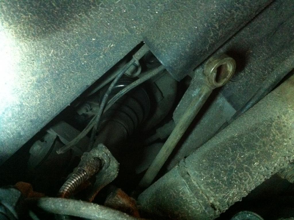

Well, first up I realise that one of my wear sensors is severed, no big deal, but more importantly the NSF anti roll bar ball joint has popped its socket! So, the car is quarantined for now. Lovely weather to cycle to work in.
However, I'm not convinced this is the cause yet, so I pulled the wheel off and spun it. There seems to be a fair bit of clicking from the CVJ, plus maybe a bit of play when changing wheel direction. I'll upload a vid and hope the sound is evident.
There's a bit of graunch from the disc brake and maybe worse in reverse but if can move the disc by hand I doubt it's enough to hold it back like I'm experiencing. However, it had fully cooled at that point. The inside disc is unevenly worn across the face of the disc so it could be a contributor. The pads only have 5mm so probably worth replacing if I can solve the main issue. Rear seemed a bit freer but not by much. Didn't notice any bearing clicks or play.

\I am glad that is off the road and you are safe. Looks like there has been some poor maintenance in the past, just how long had that been clunking away for ? :).
Rawce
Posts: 40
Joined: 07 May 2012, 17:04
Re: Rear Brake? Please Just Be the Rear Brake!
Unread post by Rawce »
Well, I was in that area over Xmas fitting the undertray. I wasn't looking for it specifically, but I didn't notice it then. I had checked the wheel arches for damage too. Likelihood it popped when jacking the NSF up.
