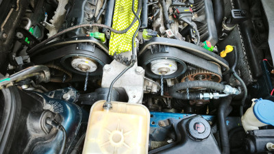

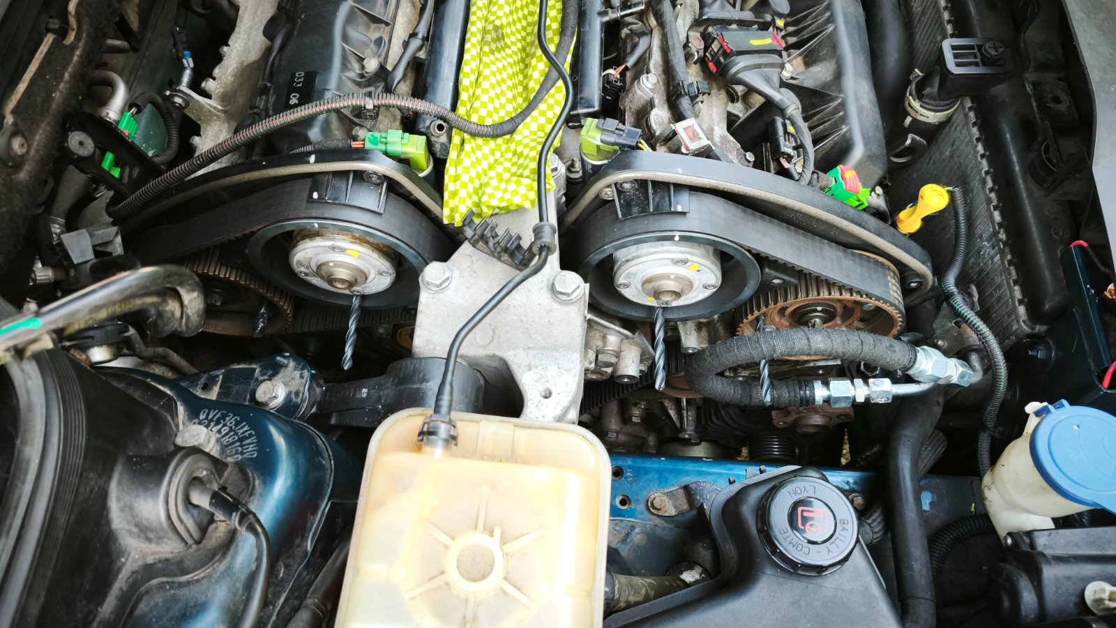

Longstart
Posts: 15
Joined: 24 Jun 2025, 19:15
x 3
Re: C5 V6 ES9A Camshaft Position Unknown
Unread post by Longstart »
So, Today I took off timing belt and all pulleys for inspection. They are little bit rusty but I cannot feel anything wrong with them. Also all pins (8mm drills fits 😀) fitted perfectly, so I think timing was good. I checked invoices and pulleys are 8 years old (SKF). Belt approx 4 years old Continental... So I dont think issue is with timing of the engine.

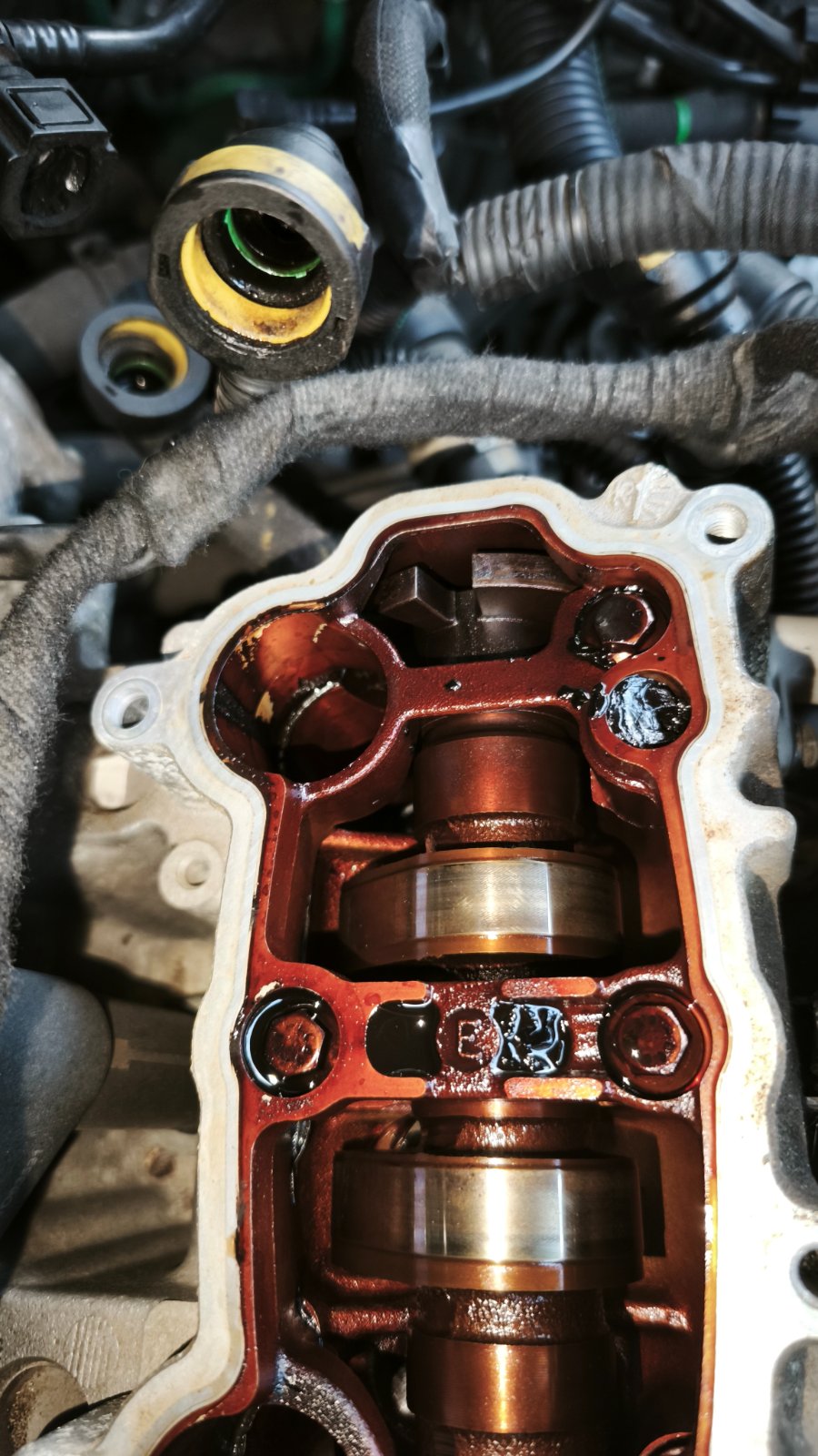

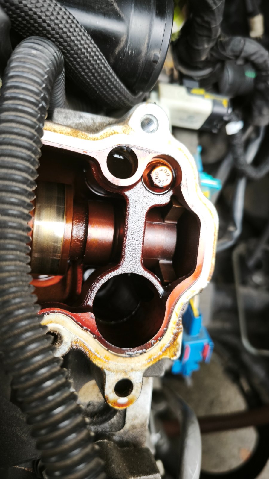

Then I took off covers of intake cams. Could you anybody please advise, if the teeth of the camshafts are placed correctly according the puctures? I tried to move them by finger and it seems they are solid with camshaft.
Also I tried to took off fixing pins from intake camshafts and intake gears are fixed to camshaft, so I would say that also hydraulic camshaft gears are ok...So I am clueless. Last think I can do is replacing of crankshaft sensor...
