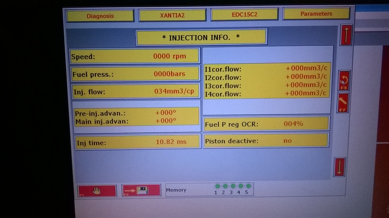

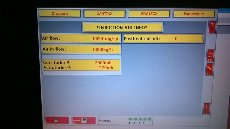

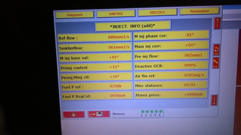

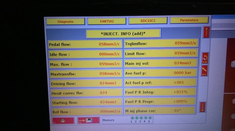

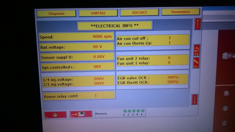

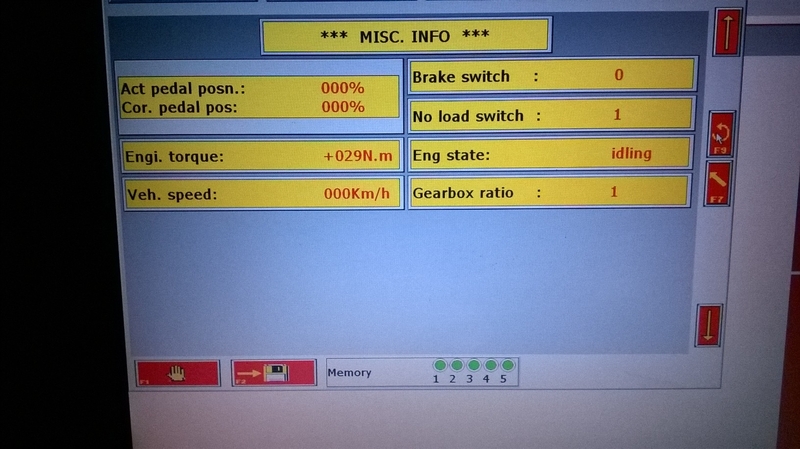

Right, So I'm wondering if this is not just a MAF issue but maybe an ECU issue? I drove to work this morning K light on as usual down on power wouldnt rev over 3K. I drove home light on down on power but I kept the speed on going up the hill and although down on power she revved over 3K all the way home it was the same. But the light reamains on and the same pressure coherence fault remains.
Ive put a few pics of the Lexia pages below. correct me if I'm wrong, but it seems that the ECU thinks the car is idling when the engine is switched off?

I wouldn't fork out for a new MAF just yet - you've tried more than one to no effect, so it doesn't appear to be that. More of the issue would appear to be that it is reading 1250mbar in the inlet when the engine is not running, whereas it is probably expecting to see a number similar to the atm pressure. I can't remember where the turbo pressure sensor is, but I think I would be looking there first. If you Lexia it with the engine running, what does the manifold pressure do? Does it climb as the load (and therefore boost) comes on?

Latest: The Lexia indicates that at least part of the ecu thinks the engine is idling all the way up to 3 or 4K rpm.. but the throttle shows movement..same problem as before up to 2900rpm when cold and dissapears when the engine is warm but the faults and light remain.
