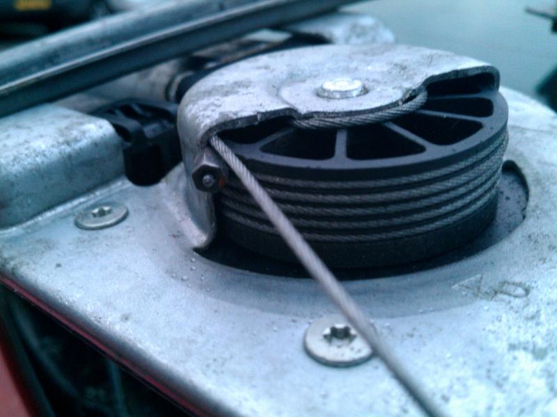

The weekend was a washout and today was looking the same but the rain abated while it was still fairly light so I went back to the fight
I slid a tie-rap around the clip allowing me to get a full hand grab and the clip yielded. The regulator unit is now sitting in my front room. Initial inspection shows the sliding clip is damaged (though that may have been caused by my assistant trying to prise it off last week). The lower spring-tensioned pulley popped itself out of it's hole so I'm unsure if it's re-usable or how it's spring is supposed to be located.
Additionally, due to winding the motor after breakage, one of the cables has got wound round, and lodged between, the spool and it's holder and again, I'm not sure if I can release it to see if there's further damage or if it's re-usable. All suggestions welcome.

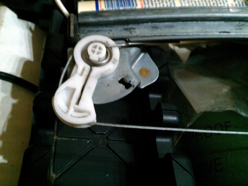

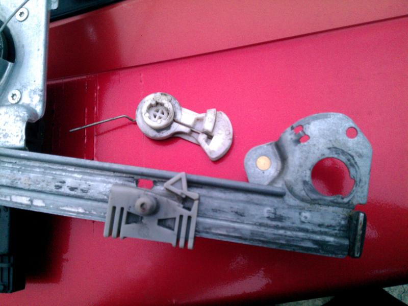

The sprung arm is OK. The arm (of the spring) engages that 'peg' at the 10 o'clock position from the keyed hole, and the plastic arm is keyed to that hole. The slide clip does need replacing (you can see where it has cracked, letting the end come out). However, from what I can see, the spool and the cable look OK, but will need inspection. Dismount the motor, and the spool will then come out easily (either on the motor spindle, or on its' own). You have to take the motor off anyway to rebuild the mechanism. This will allow the cables to come out without any further damage.
Looking at the slide, there appears to be a hole right where the sliding clip is. If so, that makes things a lot easier. You will want a couple of cable ties. Loop one around the free end of the spring arm, and leave enough room to thread the other cable tie, but not enough for it to pop back off (make sure it does not impede the path of the cable over the grooves on the arm). Fit the arm into place, but don't (yet) rotate it into its sprung position. Fit the second cable tie so that it passes through the hole in the slide and the cable tie on the arm. Pull the arm up tight and take up the slack on that second cable tie. If that works, you now have made life easier when you come to repair the mechanism.
The sprung arm is fitted the on this side of the slide (as shown in the first photo), but the other way over. The arm, when fitted, keeps the tension on the cables to allow for the anti-pinch mechanism to work, and to keep the cables on course.

Fortunately, having an assistant is easier than using cable-ties. We freed the spool and checked the cables - no kinks or damage to worry about, thankfully. Rewound the cables, refitted the spool then set about trying to make ends meet (so to speak). Even with the spring arm fully loaded and the bottom cable fitted, the top cable nipple comes up a couple of millimeters short - presumably the cable windings could have been tighter or am I missing something?
I've ordered a new clip and will revisit this when it arrives but I'm wondering how to set the sliding clip in the right position to re-attach the glass - I presume I can connect the wiring and use the motor?

I would take a look at the first major write up I did. It is difficult to guess how much of each cable needs to be wound onto the spool to let the slide clip be in the right place. You can (once the mechanism has been re-assembled) connect up the lead (and switches) and then position it accordingly, but I would then disconnect the switch (and take the key out of the ignition) so as to prevent accidental moving when you least require it.
All of the parts are correct (obviously, as, barring the replacement clip, they are original), so everything should fit. I think I had a similar issue at first, and it was because I had not properly seated the white spring arm, so it was not moving through its full travel. Once I got that sorted it all went back together properly. I would remove the spring and then pop the arm into place so that you can see how it goes together and how far it moves without the spring hampering you. Once you are happy you can take the white arm back out, fit the spring back in, and have another go.

I'm confident the spring-tensioned pulley is properly fitted and was at it's furthest reach as it was against the pressed stop bump on the rail. Oh well, see what happens when the part arrives and I attempt refitting the spool and cables for real - hopefully Thursday.Hell Razor5543 wrote: I think I had a similar issue at first, and it was because I had not properly seated the white spring arm, so it was not moving through its full travel. Once I got that sorted it all went back together properly. I would remove the spring and then pop the arm into place so that you can see how it goes together and how far it moves without the spring hampering you. Once you are happy you can take the white arm back out, fit the spring back in, and have another go.

I think you might have the sprung arm incorrectly aligned (and I apologise if I did not make it clear in my previous instructions). I would remove the spring (for the learning curve bit), turn the white arm over (as related to the top of your two pictures), fit it into the slide, and then pivot it anti clockwise until it stops, pointing roughly at the spool location. That is its normal alignment. The bump stop is for the slide clip.
Imagine the frame cabling is a low, flat triangle, with the slide clip spigot (the bit that goes through the hole in the window) pointing vertically. The spool is at the top of the triangle. One cable comes off the spool, goes down to the grooved wheel at the left of the frame, round it and then onto the clip. The other cable goes down over the free end of the white arm, around the grooved pivot bit of the arm, and then onto the sliding clip. The spring arm is there to keep the proper tension on the cables. I hope this helps.
EDIT; This is for the nearside window, but it could help to show how things go back together;
http://www.ebay.co.uk/itm/CITROEN-XANTI ... 4165df6677" onclick="window.open(this.href);return false;

Sorry. Probably my lack of precision in writing of detail makes you think it's wrong so I got the camera out.
I used these pics for hints
http://www.aussiefrogs.com/forum/attach ... ld0866.jpg" onclick="window.open(this.href);return false;
http://www.aussiefrogs.com/forum/attach ... mbly-2.jpg" onclick="window.open(this.href);return false;
and this is mine now (without cable tension pulling the pulley against the stop, ie spring at rest)

You have got the white arm in the right position, but it can rotate round further by about 30 degrees to the right (as shown in the second of the two aussiefrog photos). You might want to push the white arm firmly into the frame before rotating it further. Mind you, that also shows the spring arm lying along the frame, which would suggest that peg sticking up is to stop the white arm rotating too far.
I wonder if that round hole on the part of the frame the white arm goes could be used to secure it in place (with a long bolt) while the spring (and the cables) are fitted into place? The hole shows up best in the first of the previous two pictures you posted.
