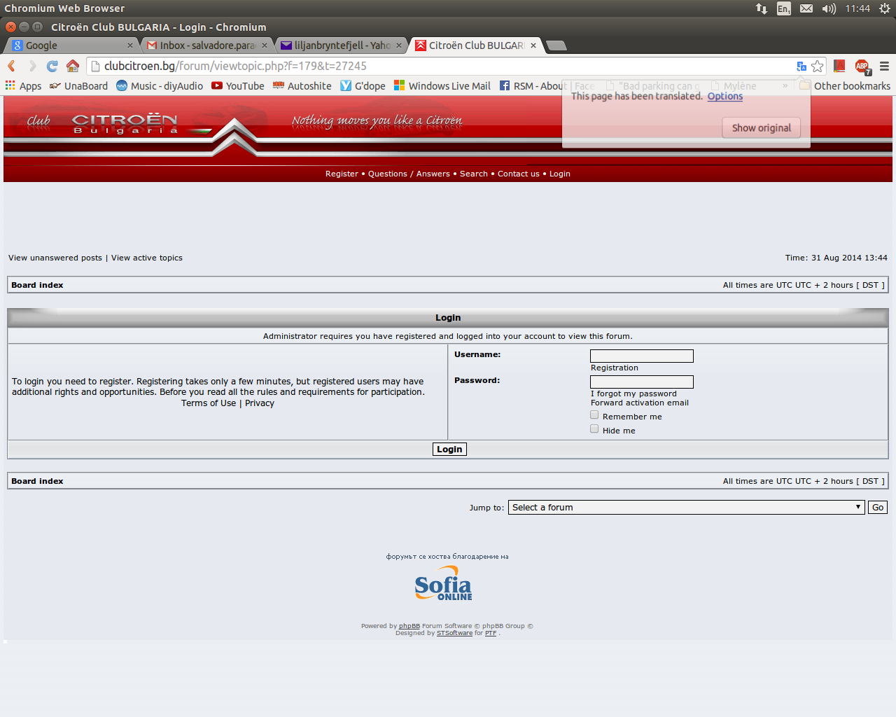

Hi, my C5-2 is in 230000 km, and I twice replace bearings on rear arms. First on 95000km. and second on 200000km. Picture from process here on bulgarian Citroen forum but to see it maybe need registration aka. Guest http://clubcitroen.bg/forum/viewtopic.php?f=179&t=27245" onclick="window.open(this.href);return false;
- Posts: 28634
- x 5648
Re: 2005 C5 weird rear wheel position query - pics added
You have to log in to that site Jovani and that isn't easy if you don't speak (read) Bulgarian.
ED:
If opened in Google Chrome(ium) it will translate and make it easier though:
ED:

I did try to register on there with a bit of help from google translate (my bulgarian is ?????) and it hasn't worked, didn't get an activation email??
Will it help though, Jovani mentions it describes how to change the bearings, not why my wheel is in the wrong place???
