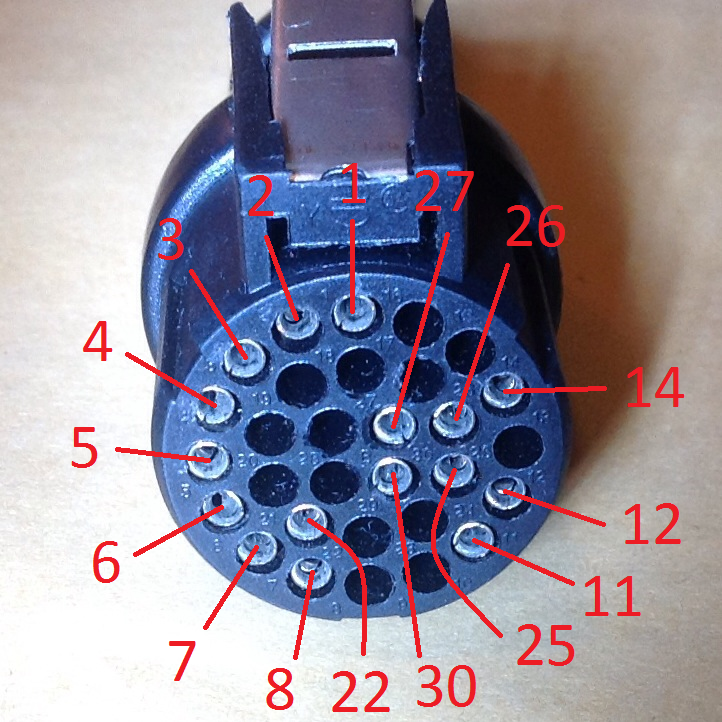

Mandrake wrote: 28 Jul 2014, 21:48 Steve, here is the wiring from the round connector all the way through to the 30 pin rectangular connector.
The pins on the round connector are actually numbered on the plug but the method of counting them is a little ambiguous so I thought it best to take a photo and show the pin numbers as I interpreted them:
Here are the pinouts referring to the above picture and the 30 pin rectangular connector on my previous post:
30 pin rectangular PSA / 30 pin round connector / Function
A1 / 5 / +12 volts
A2 / 22 / Switched (?) +12 volts
A3 / 3 and 4 / Chassis Ground
C1 / 25 / Engine ECU K-line
C2 / 12 / Engine ECU L-line (?)
D2 / 2 / GMV2 test (?)
E1 / 8 / K-line ABS
E2 / 14 / K-line Clearance adjustment (Hydractive 2 ?)
E3 / 7 / K-line Steering wheel module
F1 / 26 / K-line Heater / Aircon
F3 / 1 / K-line Air Bag
G1 / 11 / K-line Gearbox ECU
H3 / 6 / K-line Door lock
I1 / 30 / K-line Rear view mirror
I2 / 27 / K-line Anti-theft alarm
I3 / 30 / K-line Immobiliser
Hope this helps. :)
A few people have asked about the wiring of these cables recently, dropbox killing external links ruined my picture attachment above a few years ago so here it is again:

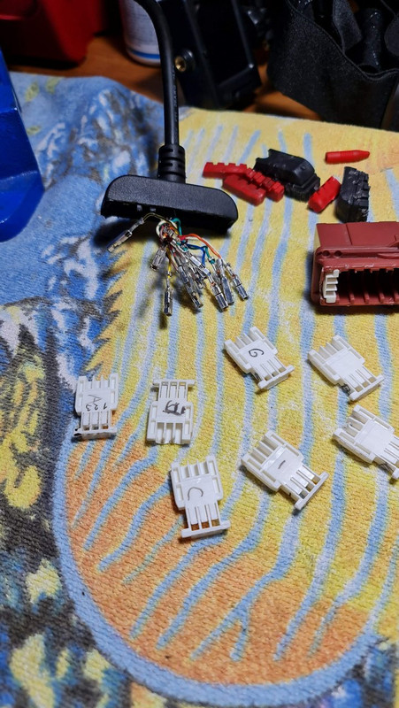

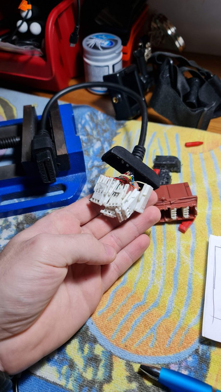

Simon, I'm gonna find you and I'm gonna kiss you!
After days of struggle I finally got it working thanks to your pinout diagrams!
The first time I saw this I didn't realise there was a page 2 on it, and it beeing from 2014 I didn't wanna write anything in here but now that you've updated it i'm gonna do it so maybe this can help somebody.
I had the 30pin to OBD 2 adapter ordered from E-bay years ago and it never worked. Looking at your schemes I realised that there were no pins where they were supposed to be for eg. A2 (ignition +12V) C1 and C2 (CAN ECU lines) were missing on the adapter. So I disassemled mine and started reassembling it back up as it should be. Finished, tested and it didn't work. Then i realised, after i saw your last post that I mirrored the OBD2 connector, actually I looked up some pinout diagrams online and thought they were meant to be for the on car side of the connector but they were not... Long story short, I didn't fry anything (luckily) and I have the adapter working now after looking at your updated pictures!

I have recently purchased a Lexia to help diagnose my XM, and I also bought a 30-pin to Obd2 adapter. Long story short, it didn't work so I re-wired it like the previous post in this thread suggested. And it worked! Partly. Only got comms with the ABS and anti-theft module, nothing with the ignition (which was the main point of interest). As I wired it directly as you guys, it should work on an XM right? Could the missing A2 pin on my 30-pin side of the adapter be the cause of this?

It is because of the poor wiring.
Both the China VCI and the 30-pin connector can be the culprit. Often it is the 30-pin plug.
There are already a few posts on this in the forum.
It often helps to try out the original plug with the China VCI. The original plug can be bought second-hand at a reasonable price.

It most certainly could be the cause as the A2 pin carries +12 Volts from the ignition. If you want to make it work you'd need to disassemble it like I did and build it up from there or cut the wires and rewire them. Which ever method you prefer but the first one is easier in my opinion.
Note that I'm missing F3 (K-line Air Bag) and I2 (K-line Anti-theft alarm) Those wires just didn't exist in my connector. And that A3 goes to 3 pins on the OBD2 Side (8, 4 and 3) I don't why, it's only one wire, not 3, must be somewhere internally spliced to reach those 3 pins on the OBD2 side. This connector works for me and can read the systems seen above in Lexia. Tried on my Xantia and my Dad's XM S2.
