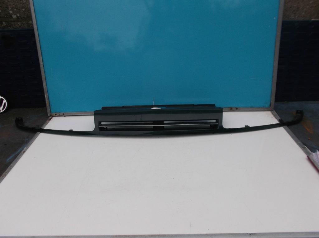

Mk1 GRILLE! I'm super excited about this and really hope it arrives safely, I've only *just* bought it. Yes it's the wrong colour, but it looks in good order and it's an easy swap to make. That gives me the debadged nose end I've been after to match the debadged rear. I need to get some paint to tidy up the repaired arch anyway so I can do them both together.
