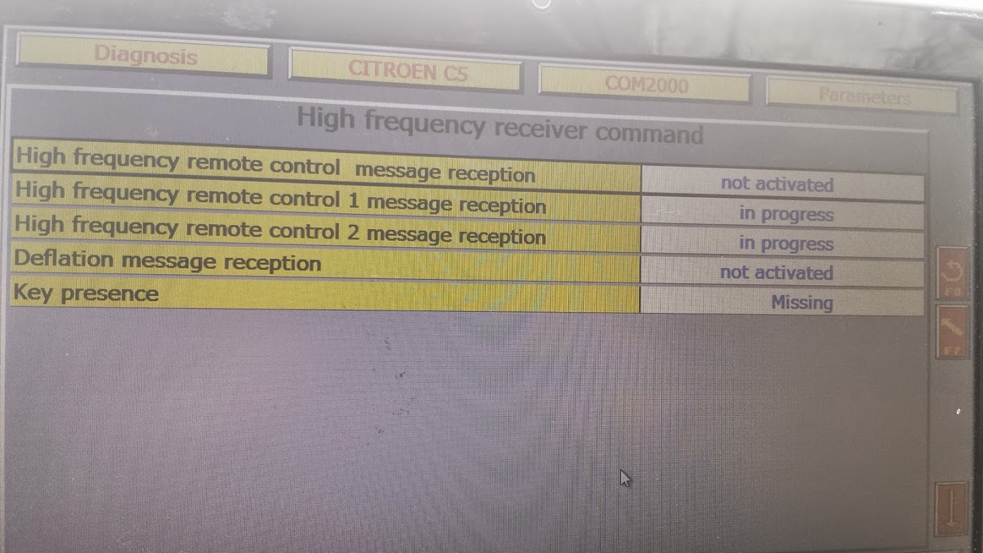

the reason I wanted a new one was for RCL.. so going off message now, does anyone know how to get rid if the 'not' from the top line of :
am I looking at a second hand BSI unit?
