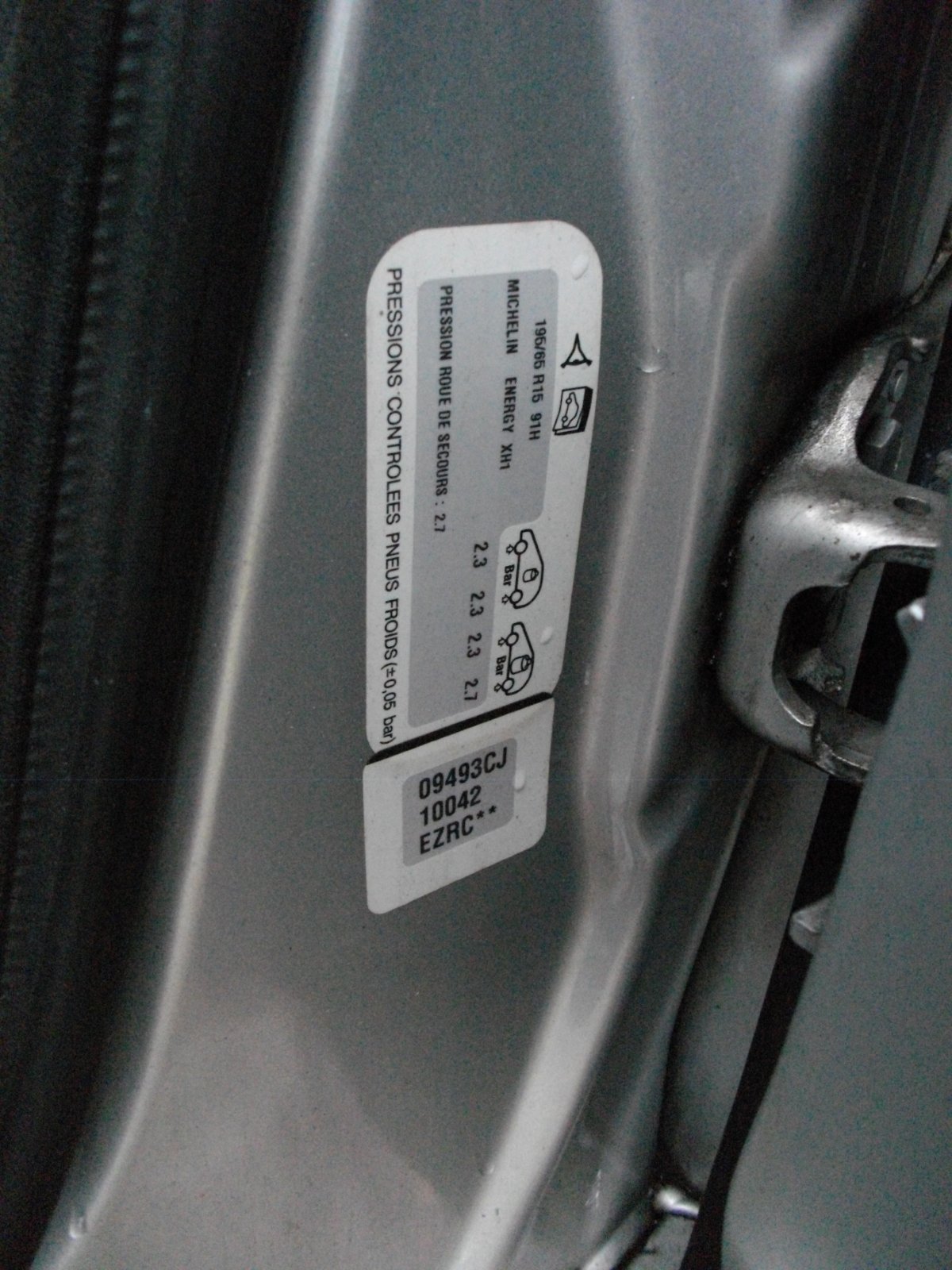

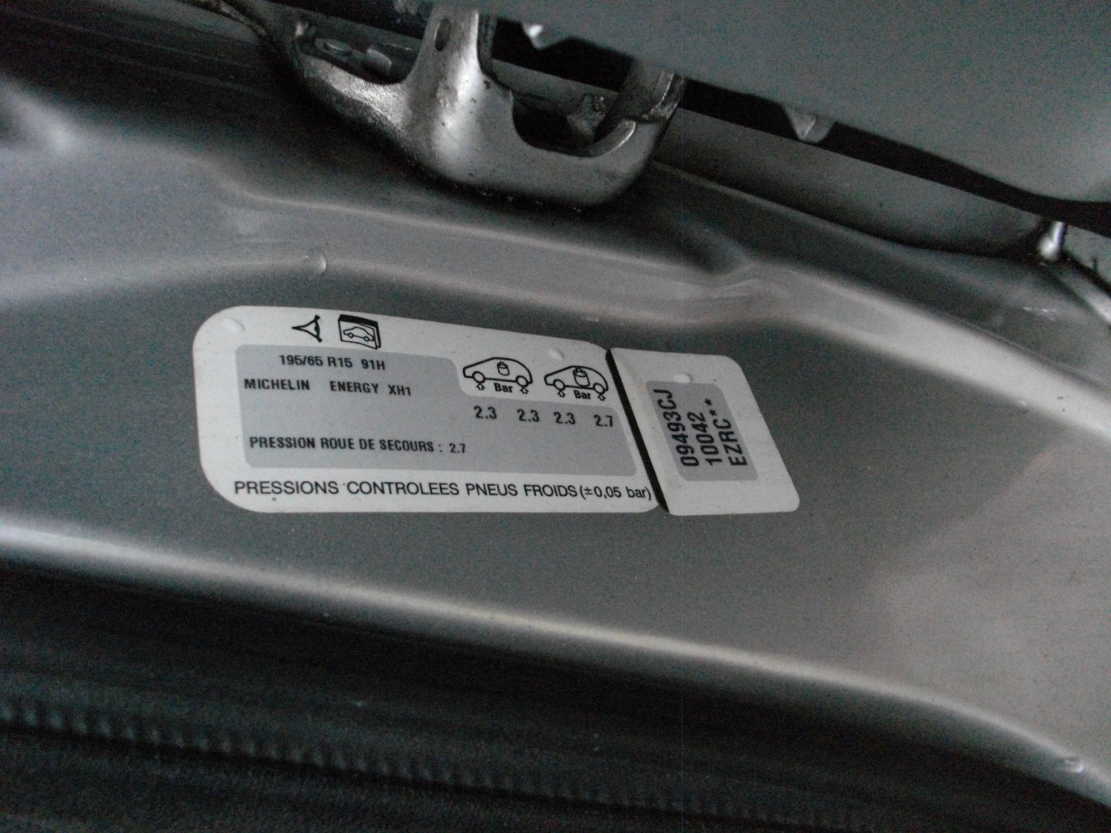

No, never did check the RPO as my son has the car most of the time now. It isn't leaking as badly as he had made us believe.
I'm resigned to scrapping the car in a few months.
RPO added
