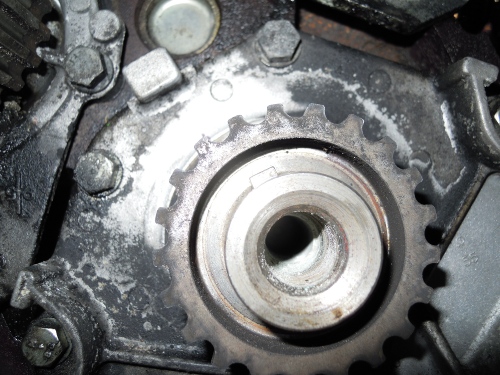

i have never noticed that circle in the alloy casting before, but i do align the rear face of the woodruf key to the front face of that raised square block just above the crank sprocket,
Regards, malcolm.

It's only visible if you clean off the crud first!citronut wrote:i have never noticed that circle in the alloy casting before, but i do align the rear face of the woodruf key to the front face of that raised square block just above the crank sprocket,
As an aside, I used to cuss the designers for using every possible size of nut and bolt head. The more I work on the XUD engine, the more admiration I have for the designers - different sized heads make it easy to identify which fastener is which: "...the only 12mm head on..." etc.
