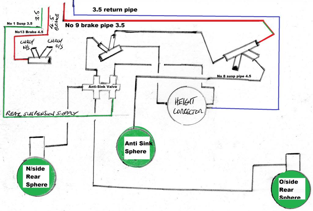

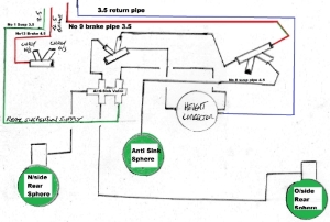

Have you seen my little diagram of the rear plumbing on my 1994 Xantia 1.9tdsx?
The full story is in my thread entitled something like
Xantia brake pipes-My No 9 needs replacing
kind regards Neil
kind regards Neil

For people in the same eyesight category as me (over 50's with less than 20/20 vision!) here is a bit bigger version

Thanks for that Neil.. Thats just confirming that it is the brake pipe .. i just now have to find out how easy it is to access at the front end.

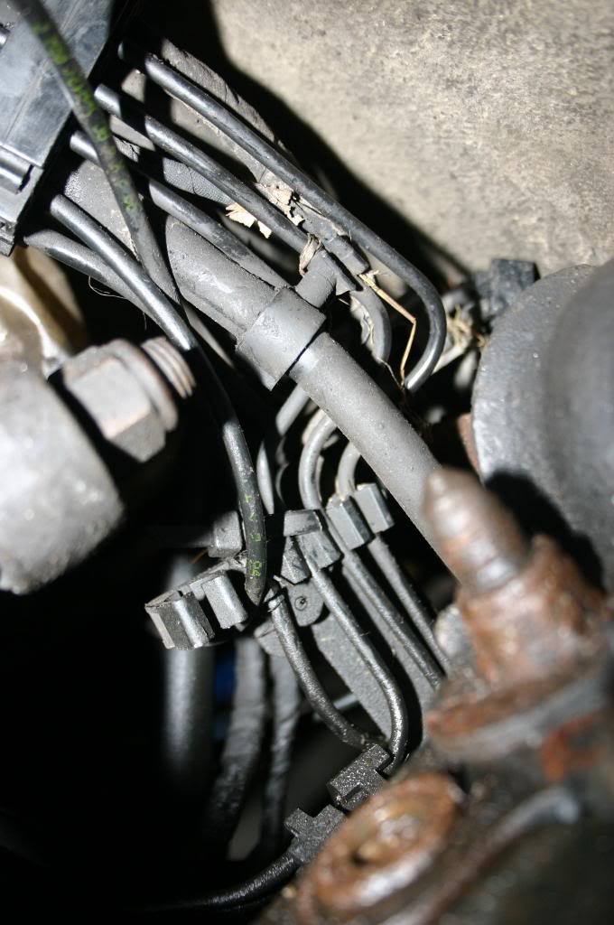

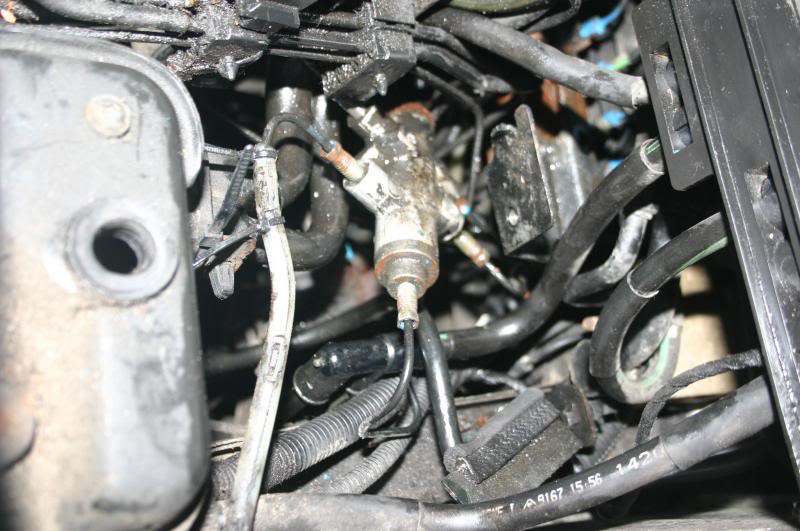

3 hours later and I'm no farther forward.
At first I tried from the bottom .. wishbone removal etc. all off apart from the LAST NUT, why is it always the last nut?Its rounded and going nowhere.
So I thought I might take Paul's advice and go in from the top well I got as far as the 5 way joiner... but the pipes won't come out ARGGHH!!!
So I decided to take a couple of pictures to share with you, give my neck a rest and ask a couple of questions.
Since I can't seem to get any farther and hopefully all the Xantia were consrtucted using the same methods. Do you know exactly which terminal the 3.5mm brake pipe terminates at? That way I'll stop trying to feel the route of the pipe and just feed the new one up.. I have a nagging feeling that I might need a joiner after all as the supply pipe (which is what I thought it was) is 3690 and the brake pipe 3768.. however there was quite a bit of a spare loop above the rear subframe .. so I'm hoping....
Are those the connectors in blue on the firewall Neil?
With the offending nut in the foreground!!

From the diagram on service citroen the no 9 pipe is supposed to go to the right hand one of the bank of 4 mounted on the firewall/bulkhead (ie the one nearest the passenger wing).
If its the full number 9 you are replacing you will have to undo the right union and pipe from the "bank of 4".
if its impossible to get at to undo without dismantling half the car trace down to under the car on a straight run and put a joiner in. You will need a tool like the one I borrowed. It made better flares in my hands on the new pipe than on the original steel but still quite serviceable.
regards neil
regards neil

The long red pipe in this diagram is the one that needs replacing on my 1998 V6 with Hydractive II. It's a suspension pipe on mine, I believe. It is only rotten on the last 2"NewcastleFalcon wrote:For people in the same eyesight category as me (over 50's with less than 20/20 vision!) here is a bit bigger version
I get the impression that Service.Citroen diagrams aren't wholly accurate.

Lunch time update..a (very) little heat helped release the 5 pipes from the connector. T
he guy who designed this wasn't a plumber!! that got me a visual with the firewall rack but no way was I going to be able to touch it.
So I then concentrated on the bottom end underneath the car and managed to cajole the cut end of the pipe out through the wheel arch.. it then took me about 2 hours to find where the pipe went .. the far side of the pipe bundle of course... and release it from the 2 pipe cluster clips that were holding it fast... 2 long screwdrivers came in handy... but the pipe would never have pulled through the grip they have is incredible.
So now I've shrink wrapped 2' foot and passed the new pipe through.. its long enough phew!!
I've moved the air intake out of the way (the whole intake including loosening the clip before the turbo, held all the rubber LHM pipes out of the way with 4 cable ties. released the, what I think is the, ABS block to give a little more room and now I can just touch the union with the spanner...but because of the surface rust I can't get the spanner to go on to the union.. thats for this afternoon..
There's still no room down there so even if I manage to get the union off with less that 1/8th of a turn at a time.
I'm not sure I'll get the new pipe on.
I've even been lying on top of the engine to try to get a better angle (it didn't work).
It feels like I'm taking half the car apart to get to this one little spot..
Oh and I almost forgot No. 9 pipe doesn't go to the nearside connector .. it goes to the 2nd in from the offside and is marked in Green.. That may help someone who is foolish enough to try this in the future!!
