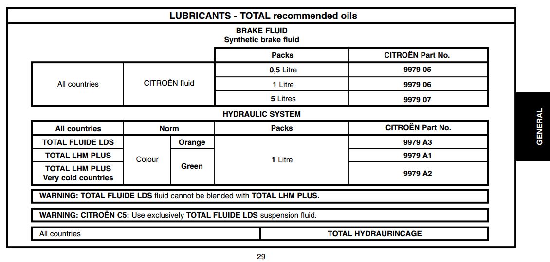

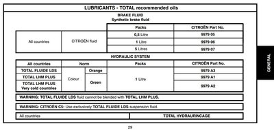

myglaren wrote: 26 Aug 2017, 11:25 . . . also Hydraurinçage is inappropriate for the LDS system.
You got me wondering what the recommended flushing agent was for LDS systems . . .
Source: Citroen, Private Cars C5-C8 2005, CAR000.020 Vol.3 p.29
Or was something else specified later?
Posts: 28674
x 5672
Re: fitted monroe comfort spheres...
As far as I am aware there is no procedure defined for flushing the LDS system.
The only thing I have heard is that inspection is recommended at the five year mark but no action specified.
As the fluid is not circulated as in the previous systems it is likely that contaminants don't accrue and need to be flushed out.
x 6956
That's correct Steve - no procedures listed in the service docs for flushing on the X7 with LDS and to be honest, no mention of flushing mentioned in the service docs for an LHM Xantia II and if it wasn't for checking the recommended lubricants docs, Hydraurincage isn't mentioned anywhere else that I can see.

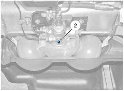

EDC5 wrote: 27 Aug 2017, 18:06 I've been tempted to bleed the rear suspension of my C5 and then replace the LDS with fresh at the front. Not for any particular reason but the thought of the LDS moving back and forth by about an inch doesn't give much opportunity for oil replacement through normal use.
Yes X7s are Hydractive 3+, but Elis has a a 2.0 Lt.
If not using Diagbox, manual method is:
Disconnect the battery.
Raise the vehicle and support on axle stands, wheels free.
Put a hose on the pressure release screw (2)
Gradually unscrew the pressure release screw
Wait for the pressure in the circuit to fall fully
