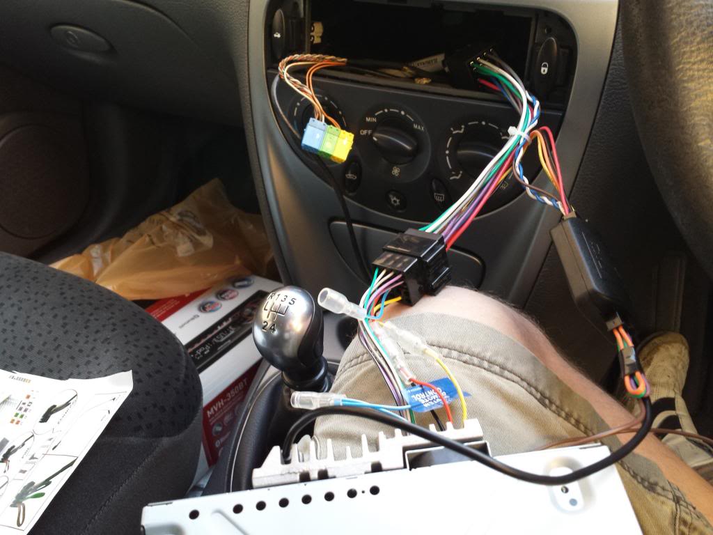

*FAIL*
mainly me! Now I've hit several stumbling blocks. The lack of an aerial adapter is not an issue, I can go get one of those tomorrow. But....
I've set it up as in the photo, plugged everything into everything as best I can. The stereo powers up and has remembered its setup (time) so I assume the lives are in the right places. However....
The stalk does not work. Now *I* think that funny bluegreenyellow plug is the stalk/steering wheel controls. There is no where for them to plug in, which would explain the stalk not working. Do I have the wrong cable after all?
That black cable is the 'patch' cable (haha) The instructions suggest I need to "make" it for my particular stereo (If I could make cables, I wouldnt have needed to buy one now would I) Is that the likely culprit? Ill happily go out and spend £5.99 on a stereo specific patch cable that will work, if thats all I need
Can anyone shed some light on my problem.....

Re: C5 Stereo replacement
The green/blue/yellow plugs should be connected to the wheel control interface you've bought and there should be a 3.5mm patch lead coming from the other end of the interface into a 3.5mm socket on the rear of the head unit. It does make a difference what patch lead you use because the different manufacturers use different pins for the same controls.
The lead I bought states "This stalk control interface will allow you to retain factory remote steering/stalk controls on an aftermarket head-unit."
There is no where for the greenblueyellow plug to plug into the leads that I have, the patch lead and control box that came with the leads attaches to the "main part" of the loom (the power/speakers part)
What make is the interface, is it a Connects2?
Yes, its a connects2
Looking at autoleads patch cables, it says they dont work with other makes of interface.
Had to look at my adaptor cos its a while since i did mine. Turns out i'm talking out my arse!
Looking at the adaptor in the picture.. the two plugs from the dash go into the left hand black connector, the brown/black connectors go to the wiring loom of the new radio and the patch lead goes from the black rectangular interface to the back of the radio. The green/blue/yellow plugs are redundant.
I was unaware that the greenyellowplugs were no longer needed!
I cant figure out the instructions on the generic patch cable, so will probably go to halfords tomorrow and buy a pioneer one.
Looking at Connects2 catalogue you should have part no CTSCT002 for the interface and CTPIONEERLEAD for the patch lead NOT the universal lead. The Pioneer patch lead has a 3.5mm jack that plugs into the back of your new head unit. If you don't have that jack lead in the new radio its not gonna work.
The universal lead seems to suggest it will work with a pioneer. will give it another go tomorrow and get a pioneer patch lead ordered if i have no luck.

Re: C5 Stereo replacement *WORKS!*
It works, apart from the radio, as the adapter Halfords sold me doesn't seem to plug into the hole on the radio (it is the correct type!)
I also saved lots of time by putting the microphone up by the little screen on top of the dashboard, and threading the cable down into the dashboard, thereby allowing me to grab it!
