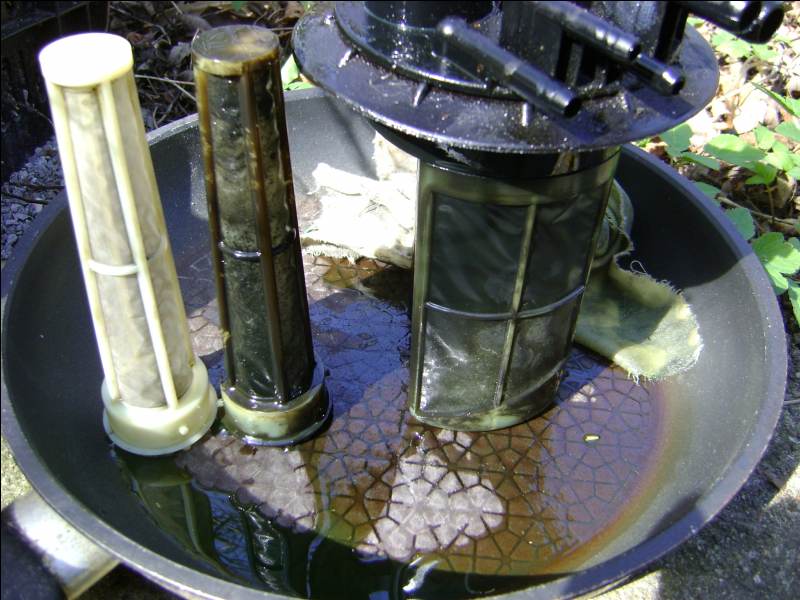

Did you check filters as Old-guy suggested?
Here you see a clean filter and a dirty one. Quite obvious.
