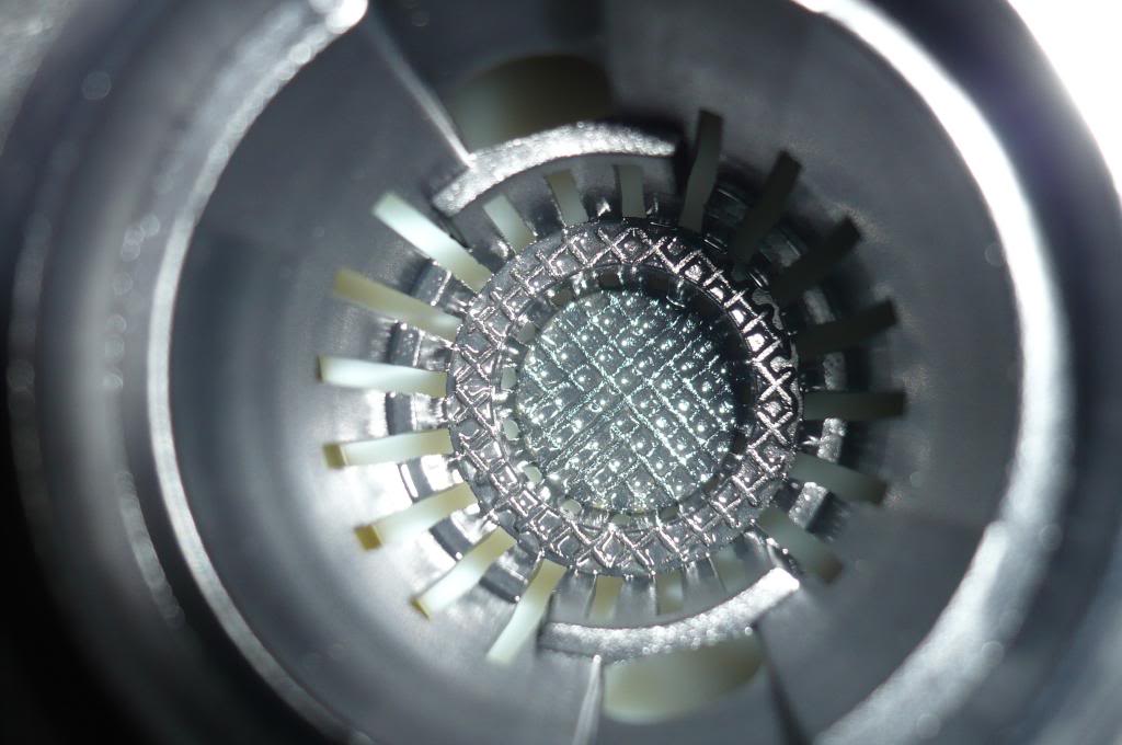

I thought there would be a very fine mesh filter inside the cap, but the fine filter must be at the outlet side. Wonder why it says "Citroen service only" (in French) on the top of the reservoir. It doesn't look like brain surgery to anyone with a modicum of common sense.

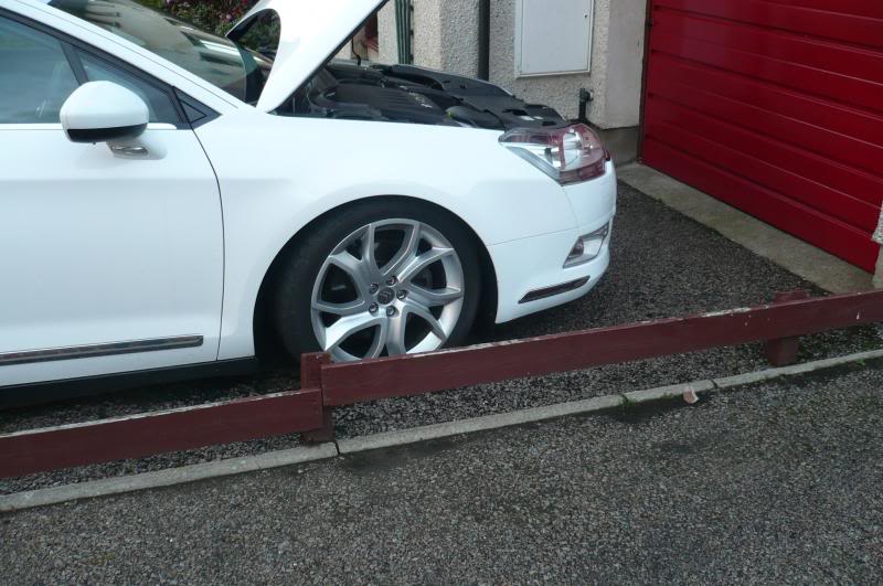

Tempted to try and see if it changes the ride which is much harder recently and the front suspension running lower compared to other C5.7
