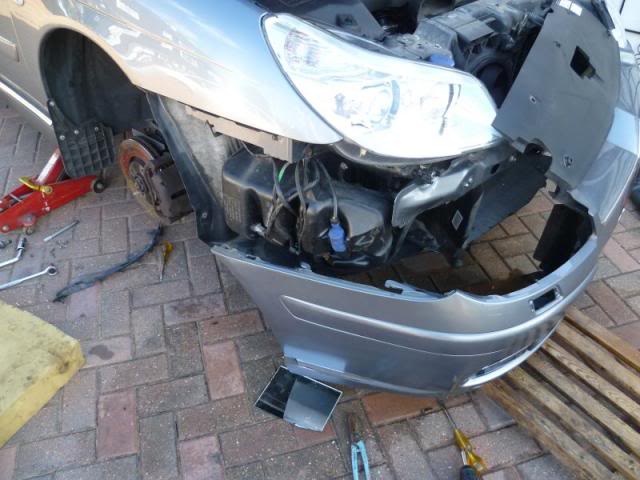

dowen wrote:Has anyone removed bumper on Mk11?
My front bumper has been off several times. At least three times to replace sidelight bulbs - now on LEDs and the last time to replace the washer pump. If the bumper is on a car with headlamp washers, it's necessary to remove the washer covers first otherwise they will break when the bumper is pulled forwards. There are several plastic screws to remove between the lower edge of the bumper and the undertray. Also more at the front of the bumper. Then there are two under the wheel arch and three more under the bonnet. The bumper is clipped into the wing so it necessary to move the bumper forwards slightly, then outwards. My picture shows the fastening. If access is needed to just one headlight then only one side need be released, but all the fixings at the front of the car need to be removed. So much so that it's almost as easy to remove the bumper entirely. Very much easier if a second pair of hands are available.

Thats brilliant, nice pic, I will now proceed when it stops raining ( April? )
What a ridiculous carry on just to change a bulb!
