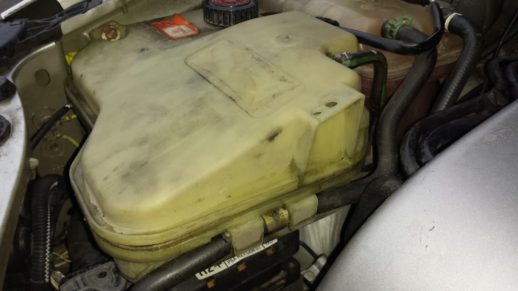

Can someone confirm the fill level on the suspension fluid tank? The level when set to lowest is on the seam of the bottle.
Is it half way in the window on the right of the bottle where the hole is for the clip?

Remove the filler cap and look inside.
The filler is cone shaped and there are a series of long and short slots cut into the sides.
LDS level is the top of the shorter slots with the car at normal height IIRC.

Thanks for the info and picture, a previous post said to check on low setting. I take it the level in your pic is where I need to be?

Re: Leak on rear suspension on C5 mk1
This is the level in my current C5 and is the same as the previous one, on normal height.
I can only presume that this is correct although there is some conflicting advice with regard to the levels and the height they should be checked at.
