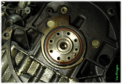

I think it was the crank shaft seal oil leak which caused him to take the car there.
evoke wrote:15/03/13 - (Went in for an oil leak) Replace clutch, flywheel and crank seal: £1300
I had this problem. Since the 110 mm oil seal (90x110x7) is on the gearbox side, first gearbox and then clutch & fly wheel was taken down in my Xantia. It took about 7 hours for a "simple" seal :x
