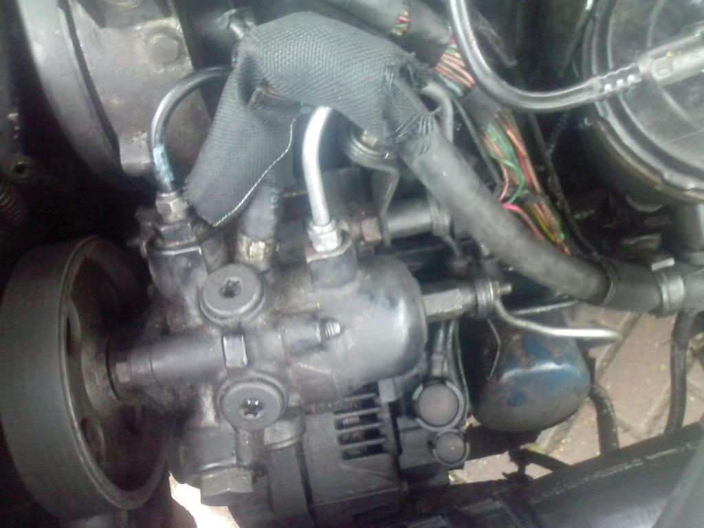

Re: 2.0 hdi running rough white smoke fault codes...
Is there a 3rd Piston deactivator on that pump?? Its a Plug that points straight UP off the top of the pump...
Im sure ALL Xantias have them, but I cant see it on yours...

taffy
- Posts: 1018
- Joined: 08 Oct 2012, 00:35
- x 1
man if ive got the timming wrong 3 times il kick myself!!! i prob bloddy have lmao!!
yea there is paul..i took it off to put one from my old pump on and lost both bloody o rings!! it was the last thing i was doing today...i put an o ring on it from the old pressur reg but it pissed out fuel so i shut it off

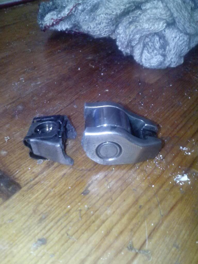

taffy
- Posts: 1018
- x 1
and the problem is......
how lucky i was to not break one when the pump jammed....then one broke the first time i started it!
one in from the vacum pump(1 i think)....all adds up now lol!
thanks again for ur help guys...i hope this will be helpfull to others in the future
