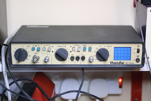

For everyday automotive use I too have a little battery operated 'scope..
One of these little babies...
It's almost vintage now but still does a great job...
Here it is with another piece of vintage test kit, something I'd be lost without, and just creeping into the picture is yet another piece of very valuable test kit for a hydraulic Citroen...

Mine if you don't recognise it is very much vintage as well. An NLS Miniscope MS-215 dating to 1978
I had to dispose of my bench scope when I moved from NZ so I was glad to have the little portable one that I could bring in a suitcase, it has done sterling duty helping me fix the car as well as a stereo amplifier and a couple of other things in the last few years...

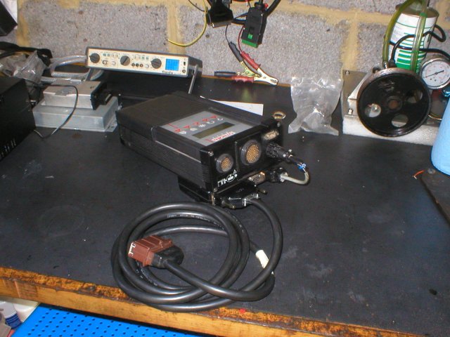

Yes, that's an ELIT Simon...
It does almost all a Lexia does right up to Xantias before the HDi came along and then all it can't do on them is the engine..
Great thing is that it's self-powered from the diagnostic socket and boots up instantaneous. There's no mucking around with laptops and it also is not interested in RP numbers or VINS. It's real plug and play and very quick for basic diagnosis..

I have another couple of 'scopes in the attic store.. That Hameg you saw above and an old Telequipment one that's getting on for 40 years old if it's a day. I repaired it and it's still good..
All my little Thandar has ever needed was a new set of rechargeable batteries..
It won't do keys though....
