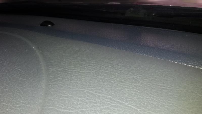

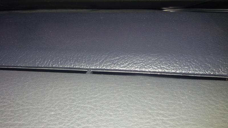

I have tried. the fog will still form.isisalar wrote:I'm not familiar with the C5 but if you could set the airflow to a face level setting rather than to the screen that should help. The problem is, the screen is becoming significantly colder than the ambient temperature and moisture is condensing on the outside. A little warm air would help, if necessary.
I have attached 2 images for your understanding:
Meanwhile, I'm finding a way to block the outlet, which is aesthetically pleasing to the eyes. Any suggestions?
Thank you very much.
Regards,
Mandrake
