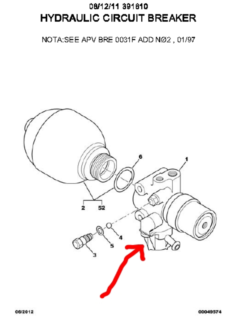

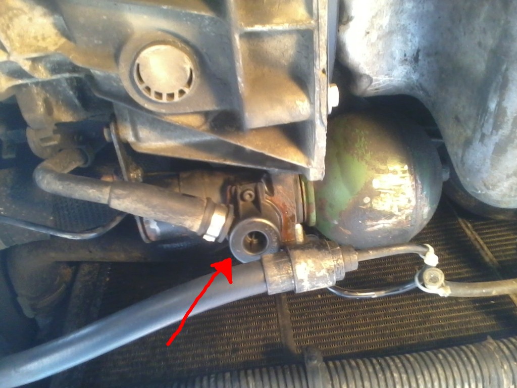

Heya, following on from the leak issue, think the leak is under this black thing.
Will prob need a new gasket, any ideas on name and part numbers? :/
Cheers romie
Cheers romie

romie
- Posts: 451
- Joined: 07 May 2010, 14:02
- x 2
Re: Xantia bouncy front suspension
Damn, this looks like it.
Unfortunately not a serviceable part?
No Citroen part numbers
Is that the front accumulator in that diagram?
If the gaskets gone, I spose I'll have to cut one myself ~ sigh.
