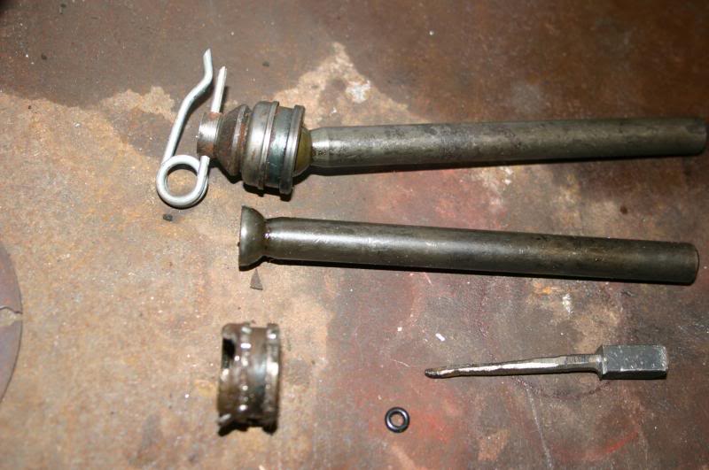

If you really want to detach the shaft.. but it will destroy the joint.. use a screwdriver to lever off the sleve joint which joins the end to the shaft.. I'll post some pictures in a few minutes.

I hope this helps..you can see the sleve/collar which lets the shaft vary its angle according to the suspension height.
The nail punch ground down to get the pin started and then a 3mm allen key minus its head to finish it off.
Do you happen to know where the O ring might go? I found it below where I was working in amongst all the rust etc that had fallen from the car.. maybe in the flow pipe?

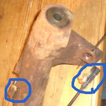

Progress tonight! The trailing arm bolt is undone (it gave a good fight getting it past the rust on the threads - god I need a windy gun!!), the ARB bolts are undone - they were tight, but came easily once cracked off, the ABS sensor is unplugged (not too bad on an estate, but tie wrapping the cable to the top of the subframe above the trailing arm is a stroke of genius - NOT!), ABS grommet is freed off (although not out yet, I can see why changing one of these is a nightmare job), sphere removed, and cylinder boot freed off - this one has some sort of spring clip on it, rather than a bolt up one, brake pipes unbolted around the ARB to give more flexibility, brake back plate removed, and caliper bolts slacked off (but I knew they would go easy, as I only put them in 9 months ago 8-) )
By this time it was 8.30 and getting dark, so decided not to fight with the arm tonight - that can wait for Wednesday. I'm still sceptical that there is enough room to remove the arm with the push rod intact - it goes in the cylinder a long way, but perhaps there is enough slack in it to allow it to come out. How heavy is the arm (disc attached)?
Tentatively, I would say that anyone facing the replacement of the strut would be well served to give the pin about 30 mins, and if it has not given in, then just progress to removing the arm - had I done this, I would probably have it nearly back together by now - although I note Neil's travails above in trying to defeat the pin in his spare arm..... [-o<

Tonight it is RW 1: Xantia 1 =D>
I can confirm you can remove the rear arm with the push rod attached 8-) Don't ask me HOW though - just kept wiggling and pulling till I got enough angle and the pushrod popped out, and then the arm came out of the subframe.
I can also confirm the pin is firmly wedged in the arm :twisted:
I used to think that the clutch clip had the highest ratio of time required vs cost of the part, however, I now see that that is woeful by comparison. Clip is £1.20 and so far 10 hours expended, and it is STILL laughing at me!!!!
Oh, and remember to remove the clip that goes into the arm from the ABS plug before you are half way out with the arm and realise that the wire won't come through the hole #-o

The drilling through the bottom bit of the "cup" that the pin fits through is very close to the bottom of the cup (see C.Morewood's picture)
There is also a destructible "collar" (se also C Morewoods picture)
Once this collar is off, it could be a possibility to weld a large nut to the end of the cup, and with a long enough lever arrangement and a bit of waggling backwards and forwards the weakest part of the structure will shear/break. This could be the pin, but in my case it was the bottom part of the cup which broke off. As you can probably see from one of my pictures the stupid pin still remained in the arm.

Pin out, and pushrod liberated from the arm =D> :mrgreen: . Having received new pins from Chris Morewood =D> I can see why they are so difficult to drive out from the outside - the end isn't flat! Cut the other end off mine and filed it burr free, a couple of good whacks and it dropped out :-D :roll: Push rod was then liberated from the arm with a bit of cold chisel action and a good wiggling :lol: My colleague is having a look at fixing the ram, so hopefully it will go back together at the weekend (hence Xantia still rating 0.5 [-X ).
I think in fact this is probably the best way to attack them on the car - there is probably access from the in board end (although not generous!) and then you can make sure are hitting the pin square on.
