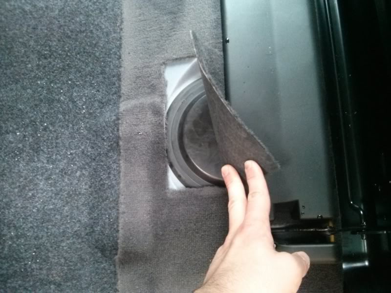

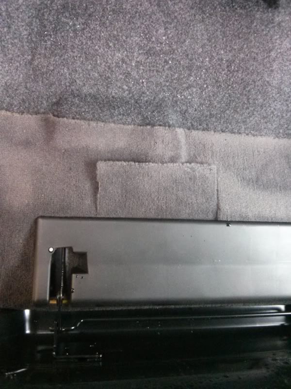

eemmm I think there is a problem the rear seat seems to be in the way of removing the black cover :(

nothing a quick pull up and a 13mm spanner won't fix ;)

I can only see two nuts where the passenger lets rest (it has like semi circles you can put luggage net hooks there.
I will try undo there and see how it goes :S

correction ... I managed to see that the plastic covers just pop out ... that then allowed me to lift the carpet a bit and take off the black cover.
So now the only thing I need is to do 300 miles lol
