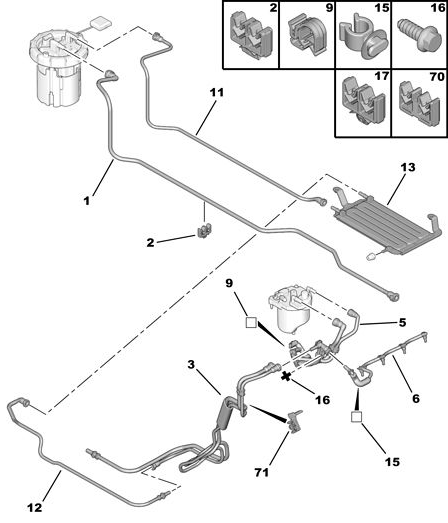

Typically item 3

Cheers mate that would be a help im flying blind here lol
Wonder if its the primer bulb itself ??
*edit* THat picture looks nothing like this setup lol
