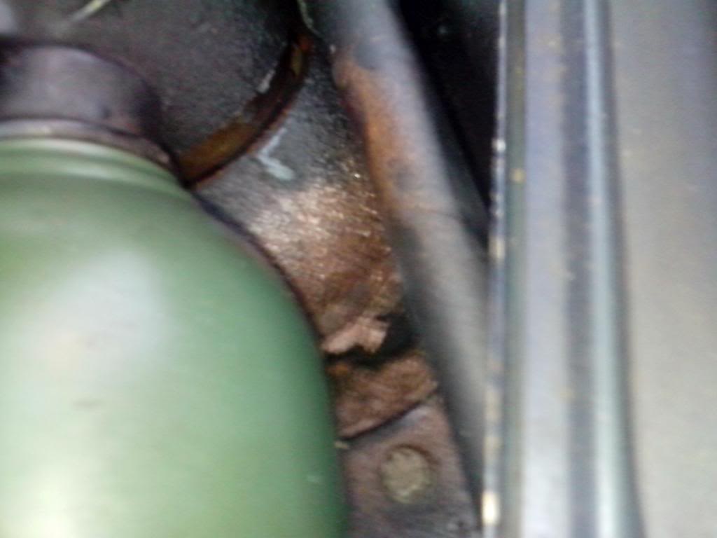

taffy
- Posts: 1018
- Joined: 08 Oct 2012, 00:35
- x 1
Re: please help!!!
]im confused lol....what is the difference in s1 tops and s2....i will post a pic lol ok how do u upload pics?

taffy
- Posts: 1018
- x 1
Re: please help!!!
can u tell me if this has worked?
