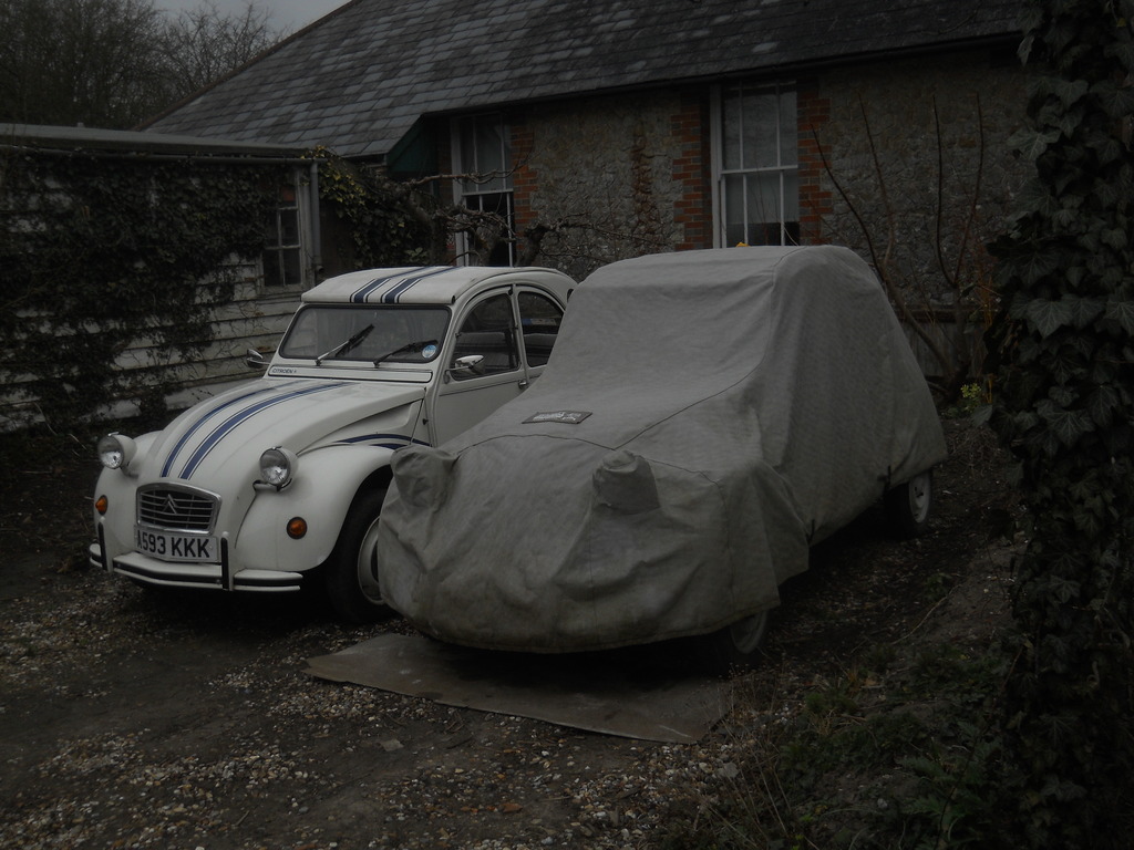

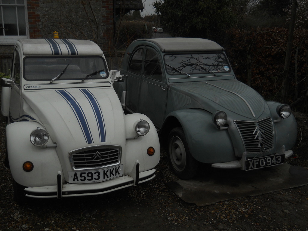

It's taken a while, but I had a camera when I visited my cousin with the 2CVs today! Even got to ride in the LHD 1960 semi auto & it's really nice.
Love the cover, my wife thought it looked like a hippo!
Blue/grey with patina next to the "new" white one.
