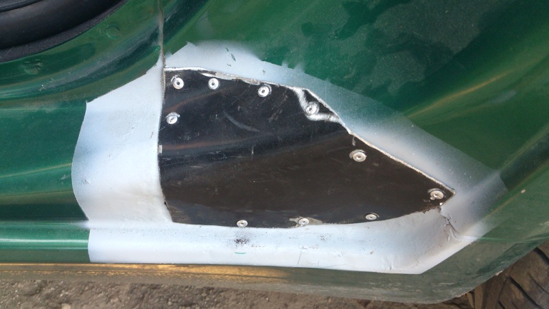

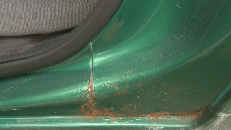

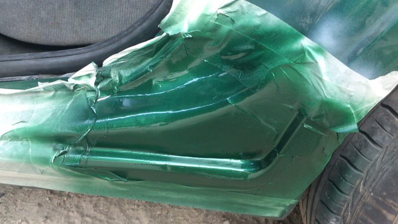

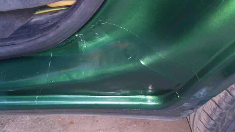

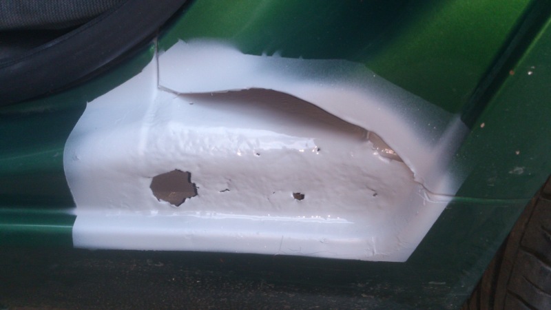

I had about same problem. I cleaned the rust with sand paper and steel brush and I treated the sheet with some solution for rust and with primer. A collegue cut from other Xantia same sheet metal in good condition. After I fixed the new sheet with rivets I used some lute, spray paint, etc... but you'll see better in photos maybe is helpful for someone. It came out pretty good considering is behind the door.
citroenxm
- Fallen Hero
- Posts: 8061
- Joined: 30 Dec 2004, 23:10
- x 70
Re: The answer to the rusty Xantia Jamb...
That IS MIGHTY impressive!!
