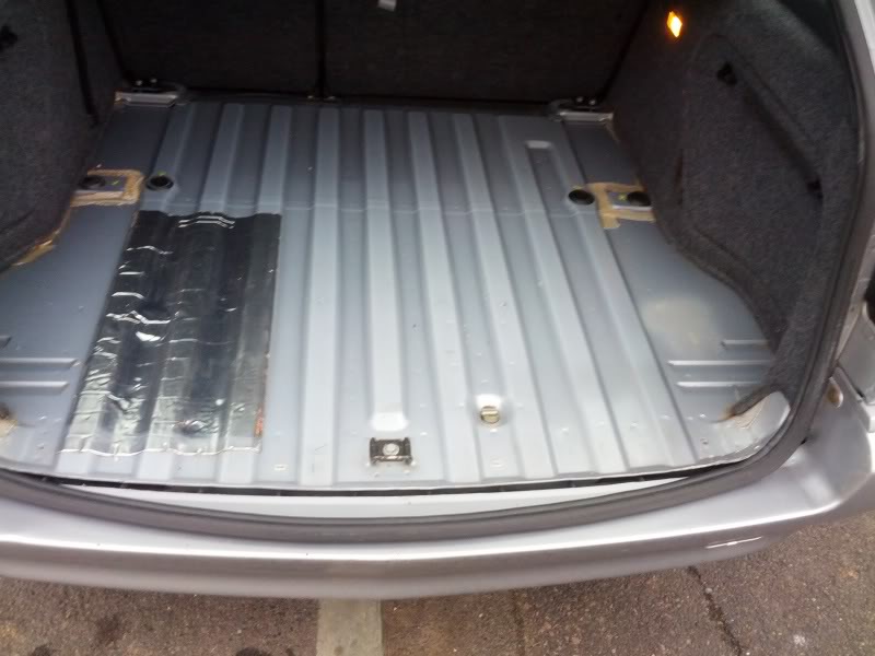

kentc5
- Posts: 227
- Joined: 25 Oct 2012, 22:27
- x 1
Re: Xantia Alarm is driving me mad!!!!
The boot lip around the bumper ... has no cabling or anything .... there is no wiring at all
The only wiring is on the boot lid, and this black switch looks like it is the alarm one :S
That black switch does things for the alarm ... ie when pressed the alarm will not make a beep sound and the hazards will flash once...
when it is not pressed the hazards will not flash and it will make a beep!
If I press that black switch in or out it makes no difference to the boot lights ... hence I believe it is purely the alarm sensing switch.
As you can see from the pic I had to remove the carpet as it was wet
but no wiring at all on the boot floor

- Posts: 14314
- x 3296
Aah, right. I didn't remember (from your previous posts) it was an estate car (or to check your signature!)!
That switch will be the right switch based on what you have written. What I think is likely is that the latch is loose, or too far down, which would result in the boot locking, but the button NOT being pressed when the boot is closed (this happened on my BX, which meant that she showed the boot open even when it was closed).
The fix is a bit hit and miss. What I did was to secure the latch as far into the boot as it would go, and then close the boot. It didn't latch, so I loosened it and moved it slightly down, and tried again. Eventually it would latch properly, and the boot warning light would go out. I think that the same would work here for you.
The other possiblity is damaged wiring in the gaitor where it goes from the boot into the body of the car. I hope it isn't, as there is very little space to work on the wiring here.
