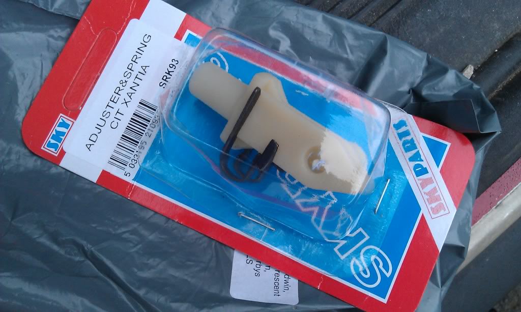

Also here is the clip I sourced on eBay, looks like good quality, agreed?
I got it side by side with the old bit and the old one does look weak compared.

Umm Im not so sure about those cheaper clips.. i bought one and it was a waste of time.. i found the metal clip did NOT slip into the cut out slots on the clip enough and it would not grip the end of the cable enough.. no end of issues... for the sake of about a tenner for a genuine citroen clip was well worth it in the end.. ended up dooing it three times till the genuine clip was in...
if the bolt head is towards the door it needs cutting off and a new bolt in from the other way...

I also only paid £5.53 (inc VAT) for the plastic and metal clips from my local Citroen dealer in Reading.

The clip, damn I thought it looked a sturdy one, will see what mechanic says or look for a localish dealer.

The fact that the broken clip in your picture is black would suggest that it has never been replaced. The cream clip is a newer design, and much better quality.
