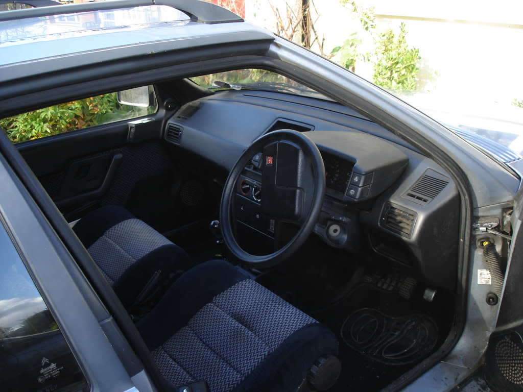

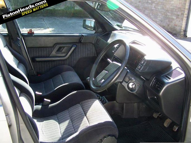

That doesn't sound right. If it was that much higher, it would be at a very awkward angle indeed and about 20cm off the floor!
I checked some images on the web, and all I can find show the brake and clutch pedal at roughly the same level:
1994 Peugeot 405 GTX 2.0 auto estate
1992 Citroen BX 19 TXD estate
