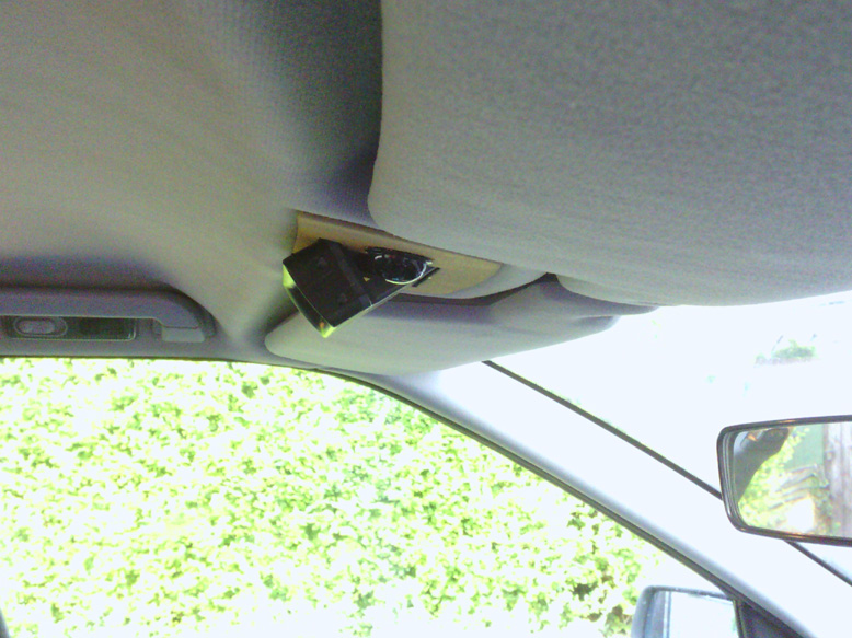

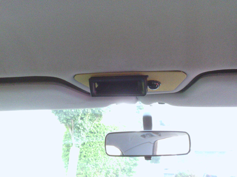

If you are lucky enough to have a car without a sunroof, I think the LCD box can be mounted in the panel between the sunvisors, tilted down about 45 degrees to be viewable. I just need to find a spare panel to cut up.
- Posts: 10936
- Joined: 09 Nov 2005, 22:03
- x 1449
Re: Xantia HDI - Cruise and Trip Computer
Like this...xantia_v6 wrote:If you are lucky enough to have a car without a sunroof, I think the LCD box can be mounted in the panel between the sunvisors, tilted down about 45 degrees to be viewable. I just need to find a spare panel to cut up.
A bit of headlining cloth and glue should finish it off nicely.
The hole was cut freehand using a Dremel cut-off disc.
Note that this is for Xantia Mk1, on a Mk2 (without the IR receiver) there should be more room to mount the display further in.
