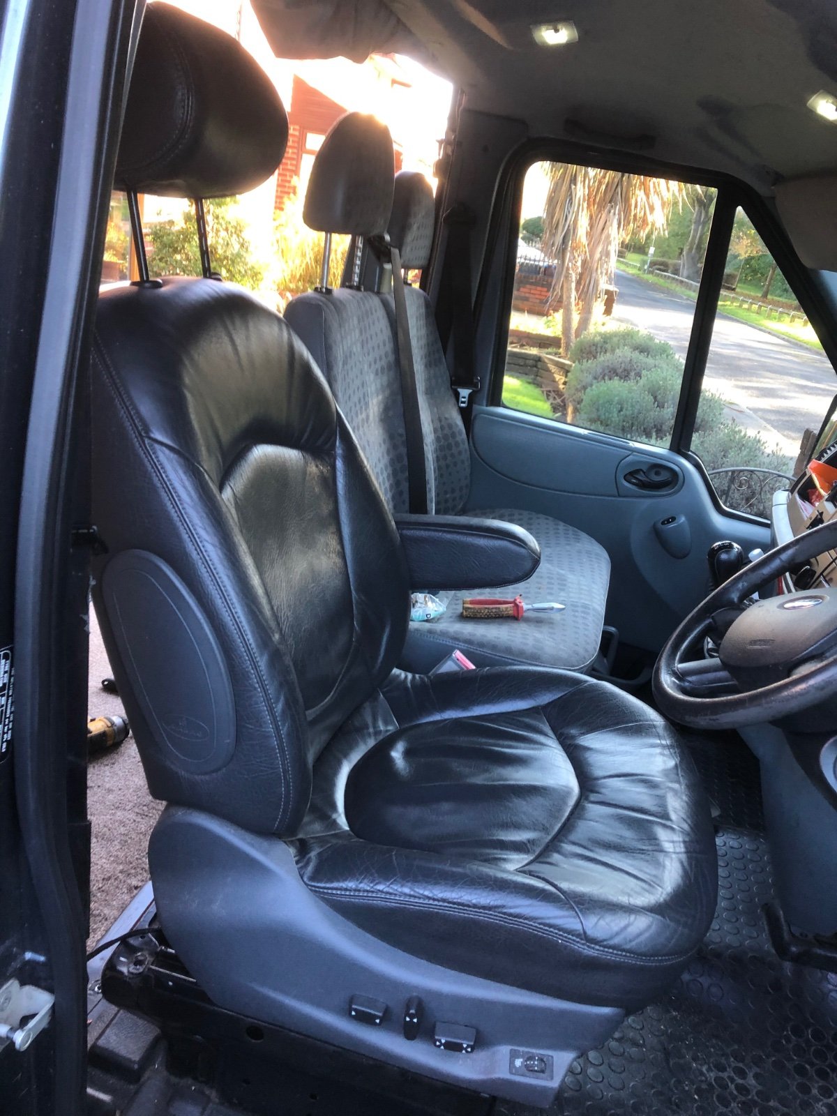

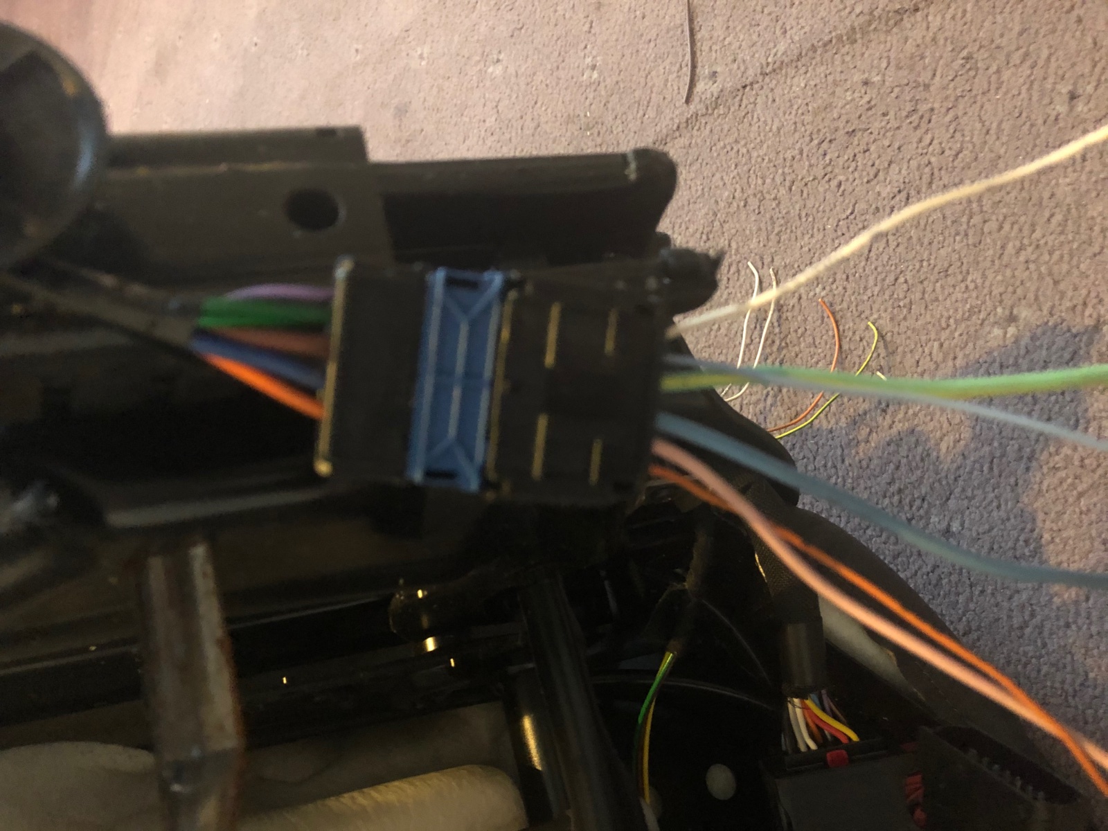

Evening guys Iv read with interest the seat info but can’t access the wiring diograms at all Iv just broken a c5 but love the elec leather seats and was thinking of putting them in my transit mk7 to replace the crap ford seats so Iv nothing to plug into for power so need to make up a loom but have no idea what is what and the plug out of the car has totally different colours to seat side of the plug so what do I need to get it working as don’t need airbag or the belt alarm to work as transit didn’t have them

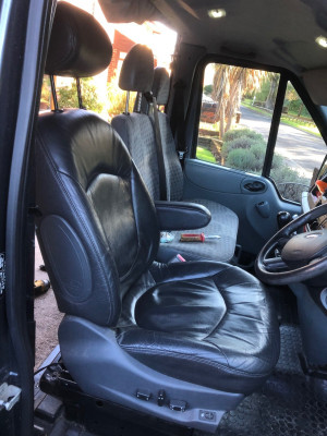

Well it’s in and all working except heated bit as not found diogram yet to suss out which wires but will soon
