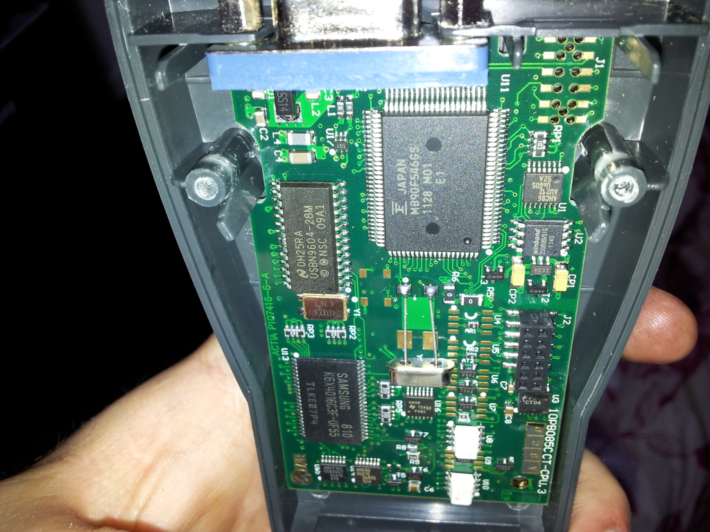

I've given up on communicating with this ECU via cables and also on the thought of desoldering the EPROM. Instead my OH has just purchased me a Dastek Unichip piggyback ECU for my birthday, which works just fine on this engine/ECU
Here's the insides of my Lexia:

Thanks Jabo.
Funnily enough, the seller that had flash photos saying his was the best quality no longer has a live listing and the photos seem to have disappeared off his ended listing.
I'll keep an eye out for him relisting in the meantime.

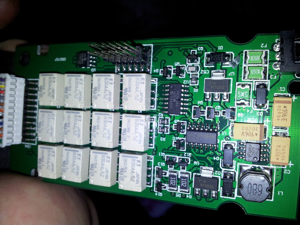

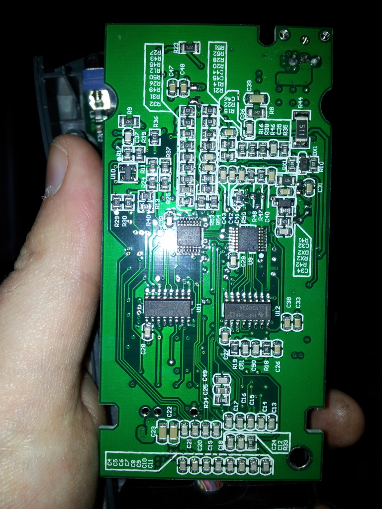

I would like to share with you some photos of a Lexia's friend bought by Ebay.
He is not clear exactly where it comes from. We have had problems with both the software that came bundled with the inteface as well can not install over Windows 7 and some versions downloaded by Emule as tests.
Have been tested Lexia3 v41, v42, v43, v45. Only the v41 allowed a good installation on windows 7 but could not establish communication with the computer of the car. The other versions are installed but generate an error related to Java and Mozilla when they are starting. I think the could work fine over Win XP.
What is your opinion about this circuitry? Could be responsible for these problems? Please excuse the pict size. In order to better show the details of the chips I posted them in a good size.
Thanks
