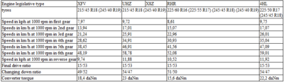

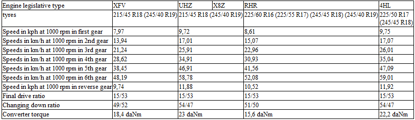

A distinct possibility and there will be software differences in the ECUs too to account for the different engine - here are the AM6 ratios:
Gearbox ratios (Epicyclic gear outlet) :
1st : 4,15
2nd : 2,37
3rd : 1,56
4th : 1,16
5th : 0,86
6th : 0,69
Reverse gear : 3,39
Some other data (RHR column)
Click to zoom
