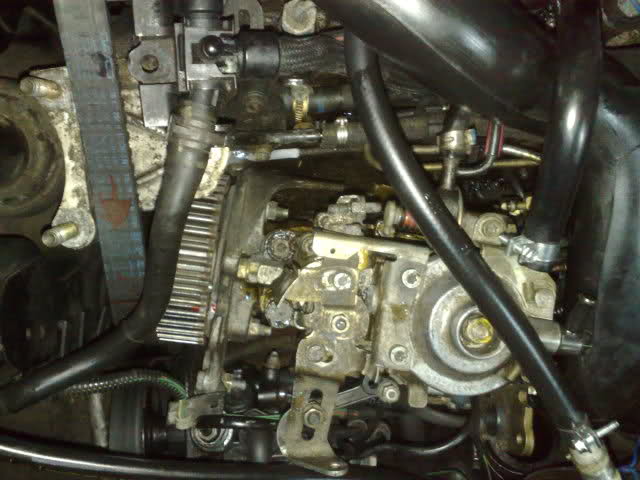

romie wrote: Hey, nice pictures!!
Thanks Romie :-D
romie wrote:Erm, over a year or so ago I removed the pump from the sprocket by, er, taping a screwdriver down each side of the sprocket. It worked very well I'll add. Didn't seem to put any unwanted pressure anywhere and the pumps been perfectly fine since then. I'm I a bad person? :p
Well, I'm always a bit iffy about using any other method to remove the sprocket other than a puller but I do know some use hammers but how I don't quite understand :?
Never a bad person!!! But I'd always be worried about bending the pump driveshaft using different methods.

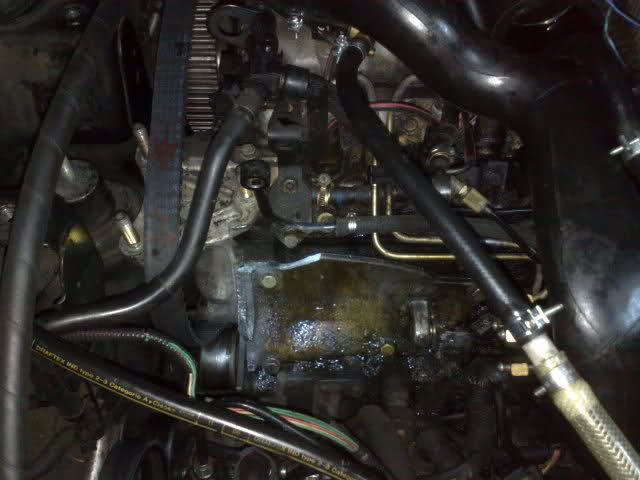

I very much doubt it but I hope your method didn't crack the cradle. Where is the crack exactly?
I'm more inclined to agree with Lighty on a potentially missing or loose rear mount or a missing taper boss on the bolt as the root cause. That bolt is special and if replaced by a normal bolt the integrity of the pump mount will be compromised. It's critical as the pump really vibrates hard in use and is one of the main contributors to the noise the engine makes. If you ever see a pump running on a test stand being calibrated you need to wear ear defenders. The din they make is unbelievable!
Also critical is to have the special serrated washers under each of the four pump mounting nuts and do them up moderately tightly. Not absolutely FT but tight enough to ensure they cannot vibrate loose...

romie wrote: What's the taper boss?
It's a special bolt with a tapered shank just below its head that is used to secure the rear pump mount to the cradle. The cradle has a tapered housing especially for this bolt...

Lighty wrote:I have seen these brkts fail if the pump tail end fixing is not fitted , or left loose, the three front fixings are not enough on their own to hold the pump.
Nice one Lighty!
BAM.
Yes! It seems that the tail end bolt is not in there!
Wasn't put back in/vibrated out... ? Dunno. But not there.
Fantastic deduction :)
This is good as I was very worried to why the bracket had failed.
Haha, nice thinking guys!!
So this is what happens after a year of not having the tail end bolt in and then you replace the timing belt with a nice new tighter version.
Xac wrote:...It may explain why your cam belt was running over the edge of the pulley.
So yes is hopefully why the belt was riding off the ip sprocket :/
