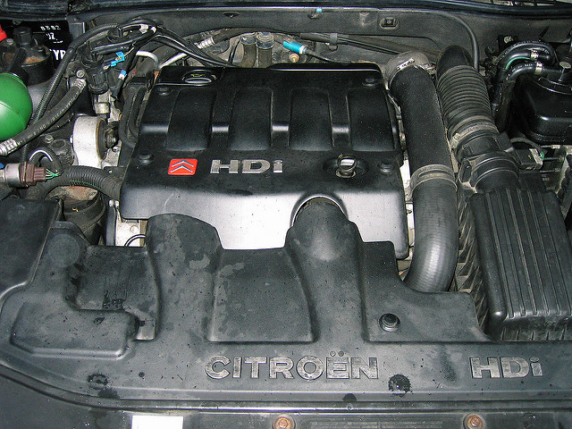

I agree that it's probably normal Diesel knock.
Put your mind at rest by replacing the undershield (it's only a 10 minute job!), and the upper acoustic cover if it's missing, and have a listen then. All that soundproofing was fitted for a reason

Quitednsey wrote: All that soundproofing was fitted for a reason
I'm still running mine without an undertray, mainly because I've not sorted out a couple of damaged mounting studs
I know that removing the undertray was what really alerted me to a boost leak on the turbo. It sounded like a howling gale under accelleration yet was inaudible with the tray in place...
