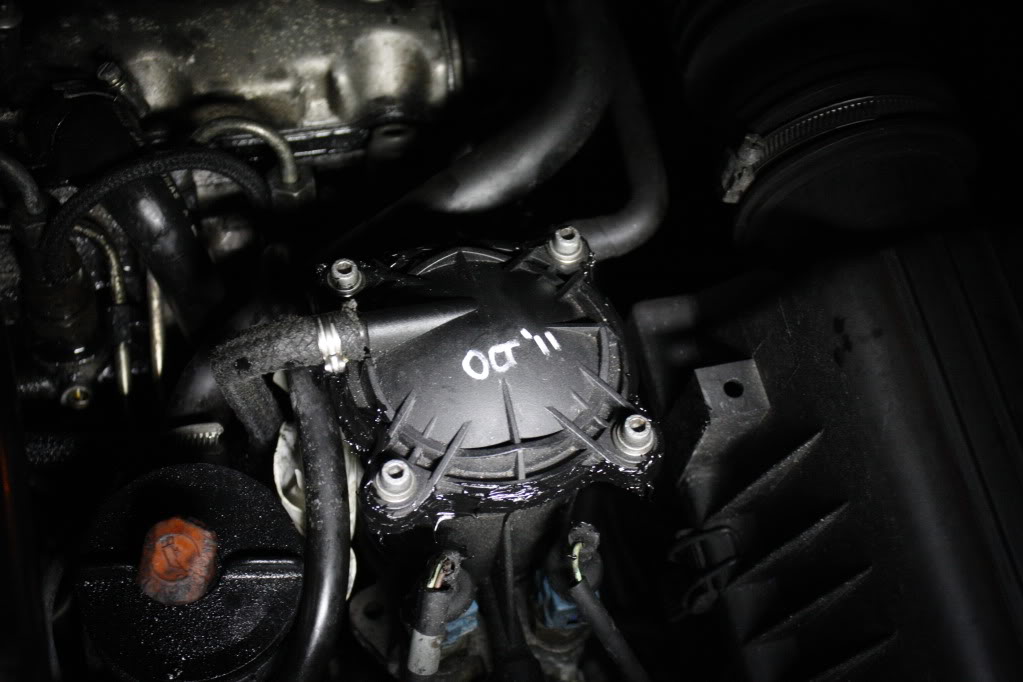

Well, it's getting worse! although it starts ok, it is lasting about 2 miles then it runs like it's getting half as much fuel as it needs, it stays like this on the motorway at 50mph and slowly improves until it runs ok. In the absence of any of the parts needed yet I have performed a bodge this evening that may or may not work.
First up, this is the diesel pipe that was slack - I fitted a tight spring clip to it and pushed it on better (slid nearly 20mm)
this was done yesterday but didn't make any odds at all.Then, this bit is leaking as discussed.
I was going to try and plug it with something but forgot that the white coloured center bit protrudes and couldn't find anything to go onto the outer edge either. The temporary BODGE was to find a jubilee clip and use a doubled over piece from latex gloves to stretch over the plug. Here it's fitted.
not ideal and I don't know if the latex will dissolve with diesel (probably) but to get to work tomorrow I think it'll prevent air ingress here.
Not to be outdone by a plastic peugeot part I spread a film of silicone sealant around the top cap seam just to be sure!
Lastly, the dreaded leakoffs are leaking here
The blank off end cap is visibly cracked and oozing.
I don't think my woes are down to any one of these problems but the result of all of these issues.
I'll see how it goes tomorrow morning..
