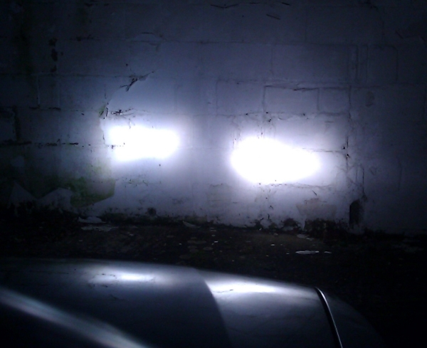

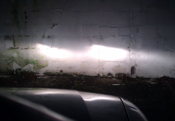

I just took 2 pics with my phone.. 2 points really..
one shows the OS main beam problem I have.. it points low.. on the road, its a splodge in front of me, not in the distance.. I have tried reseating the bulb but to not much effect..
the pics also show the difference between standard 55W dip and 100WW ebay cheapy bulbs.. although not that clear, the 100W mains are a factor of I guess 20-30% brighter/whiter.. (bulbs about 2 quid each)
all bulbs have the relay mod, and reasonable cables.. car was not running when pic taken.

Bulb pattern looks ok, so bulb must be in correctly,are you saying they wont adjust up ? they do look low.

hi lighty.. the dips are good.. not to high and the best they have been.. it's just the OS main.. it's low (when actually on the road) there is no distance at all.. they seem bright enough but not lonmgrange, esp the offside.. I may need to tweak the metal seat a bit.. just had a go by hand moving the bulb and it settles pretty much at the center of the OS dip..
I would be better off taking a pic further from the wall.. the ground is uneven as well, so although they look low, they are ok on the road..
