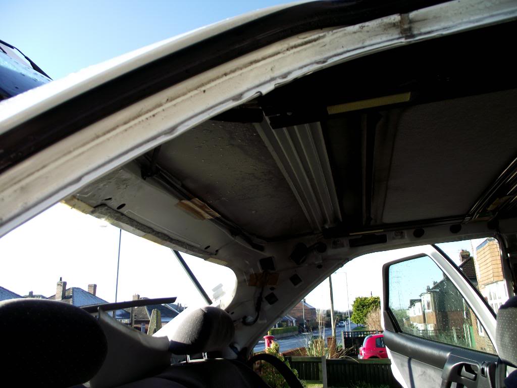

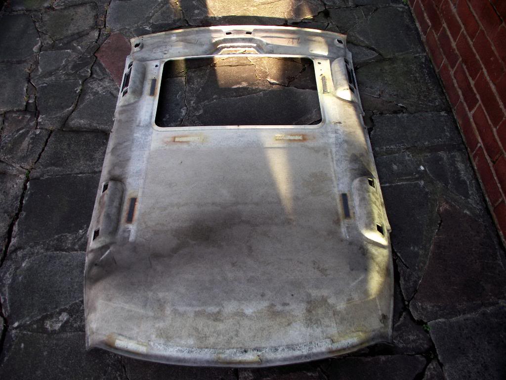

Started by removing the headlining:

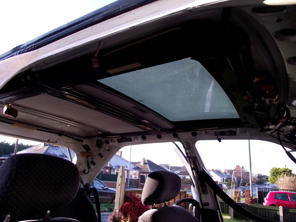

Removed the sunroof cassette. There was a lot of moisture in the roof cavity:

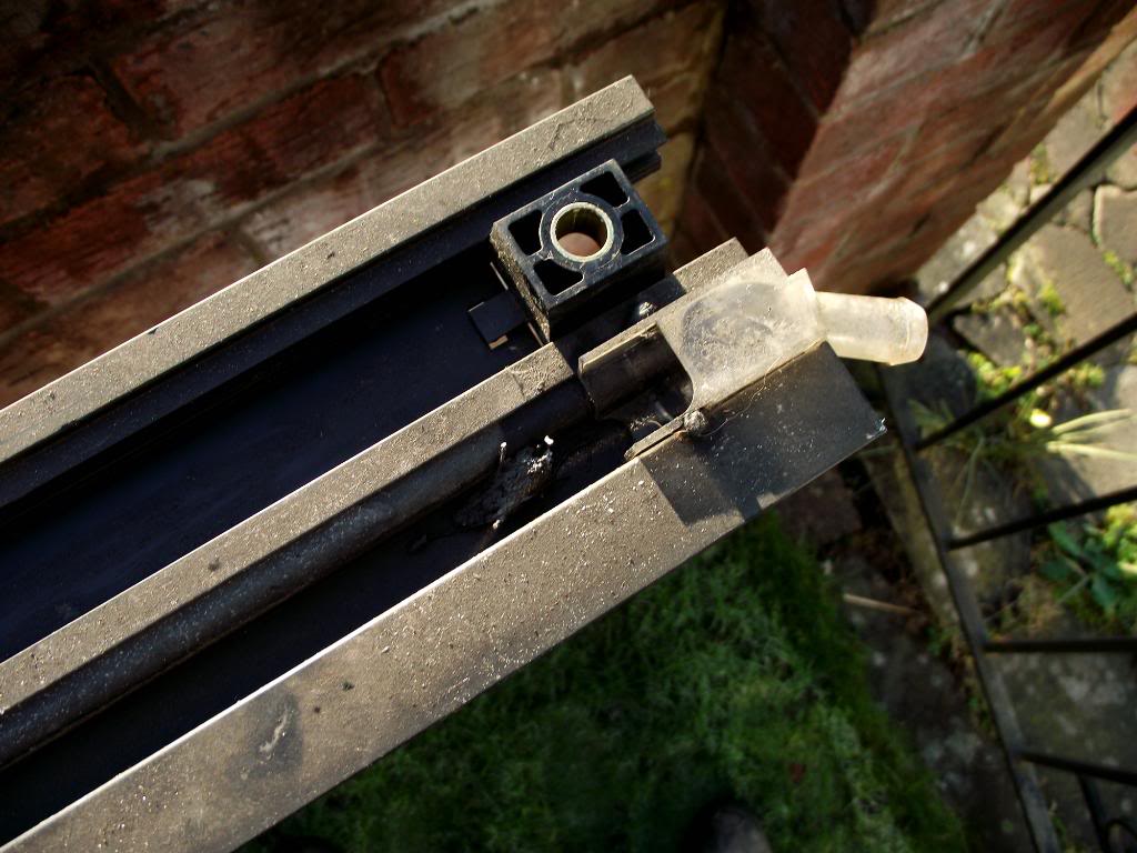

One of the drain pipes had this in it:
Oddly enough this was in the side of the car that appears dry

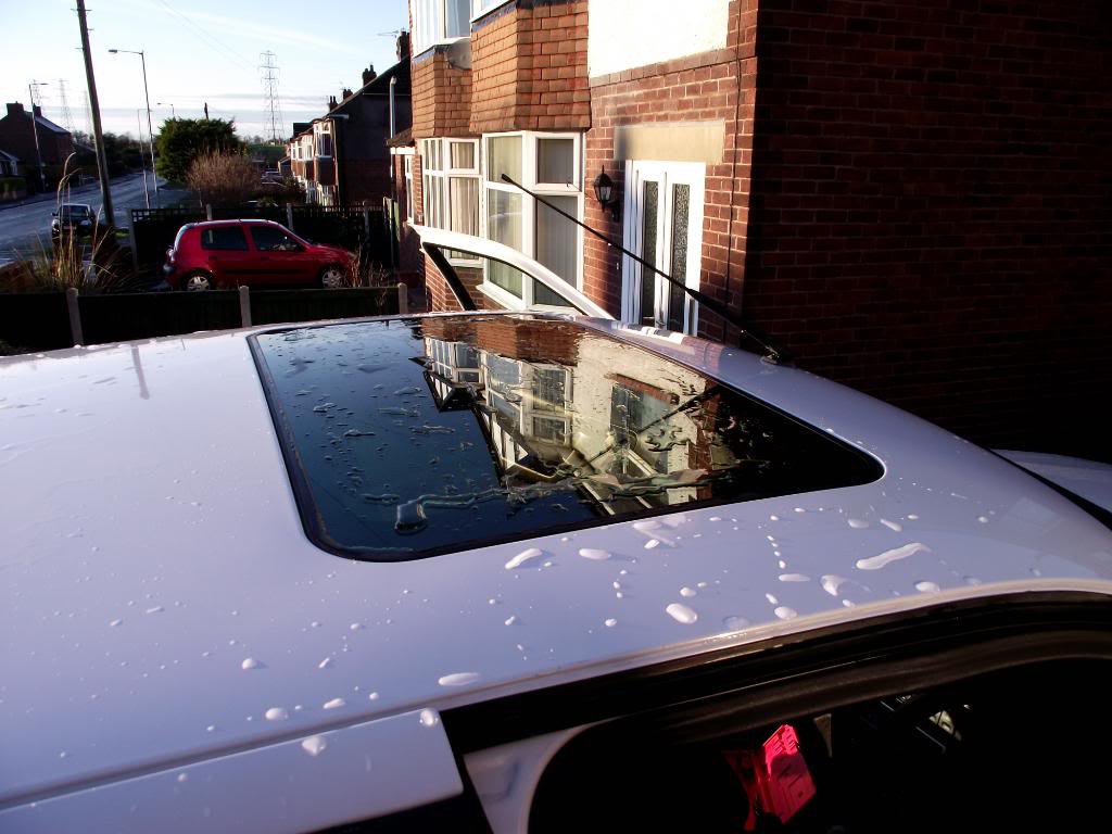

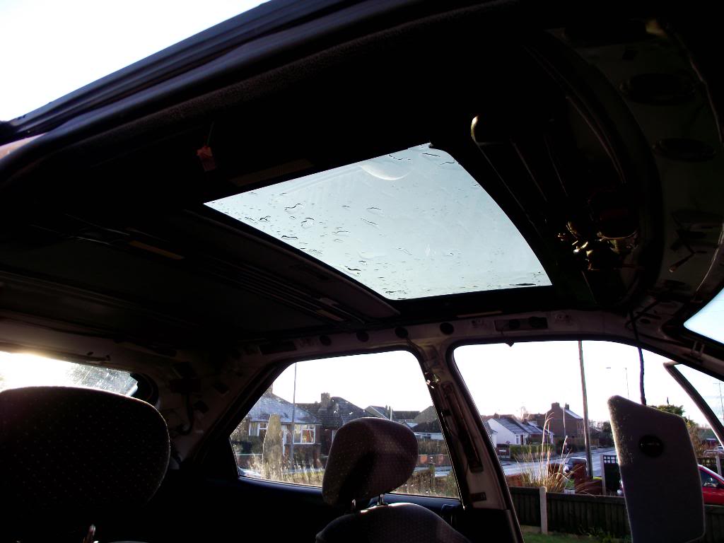

After a test with a watering can:
I was sat in the car at the time and the good news is it didn't appear to leak. I could hear the water going down the drains though
So what was the problem then? After refitting the sunroof cassette I noticed the front of the sunroof was in the closed position rather low. I adjusted this as it is a simple operation. Looking at the design of it I'm wondering if it was simply that the front was too low allowing too much water past the seal and the drains couldn't cope.
