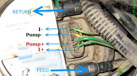

carpysmith wrote:... Out of curiosity i ran a feed direct from battery to pump and it does not work (didn,t want to do it until i knew which wires/terminals to connect to!!!) ...
This pic is from mine (Petrol) but I think they are similar.
It 's a VDO fuel pump and the wires are as seen below.
I hope this helps :)

Vertvega, photo is spot on, bosch pump on mine, but the plug/wires are the same, pipework in a different position is the only difference!!!
