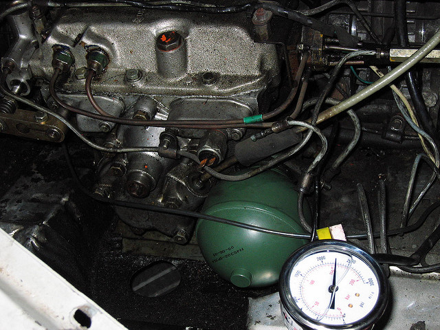

This is all very, very informative - thanks everyone
Clearly it would be best to have my Xantia's H2 working correctly. But it's not and even after time and expense it is not something I want to live with.
Simply, what is the next course of action for me? I am considering that maybe the sphere(s) are not happy. So those will be checked. Then, if they are fine, what next? A hydraurinçage? Some have said that might - others have said it might not - solve the problem, but it is an additional cost - by quite a bit given the fluids and time - so I won't do it unless I really have to. The LHM's new and the car's done 83k miles, so I would hope it isn't critical.
So assuming the spheres are OK, is it a suspect electrovalve? Are replacements easy to obtain and easy to fit? Also, alluding to a point Sir Jim of the Spheres makes, how straightforward is it to test the pressure regulator's output pressure?
OR, do I cut my losses so to speak, remove the F8 fuse and fit non-hydractive spheres all round?
Help me decide - with a clear plan of action... please!

If the sphere's turn out to be OK I'd try the easy things first such as removing the electrovalve return and observing the flow of LHM according to the state of the valve as in open or closed. I wouldn't think that Hydraflush will sort it out but I stand to be corrected on that point.
I'd certainly look to test the pressure regulator by fitting a pressure gauge to the pressure regulator output as as I did in the photo from my DS below, I foolishly presumed that pressure regulators just worked correctly pretty much forever but I've been quite surprised since I started testing them that that isn't the case. Obviously you'll need a pressure gauge and a length of pipe with the correct fittings thereon, if you don't have easy access to those I wouldn't think it'll cost much for a Citroen specialist to do the test for you as it'll only take a few minutes to set up if you already have the equipment.
Electrovalves are still available and apparently not too bad to fit although I understand that the valve can be very tight to undo, Jim'll answer that question as I know he's done that task a few times, I haven't.
If you don't fancy getting your hands too dirty I think a quick call/visit to Martin at Pleiades will get you to the source and resolve this matter quite quickly without great expensive.
