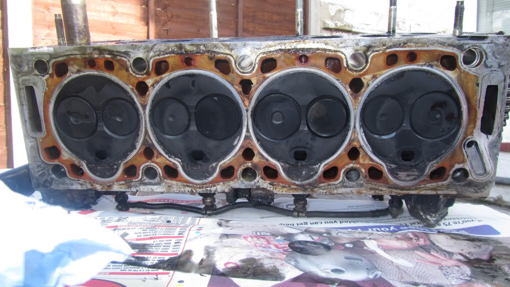

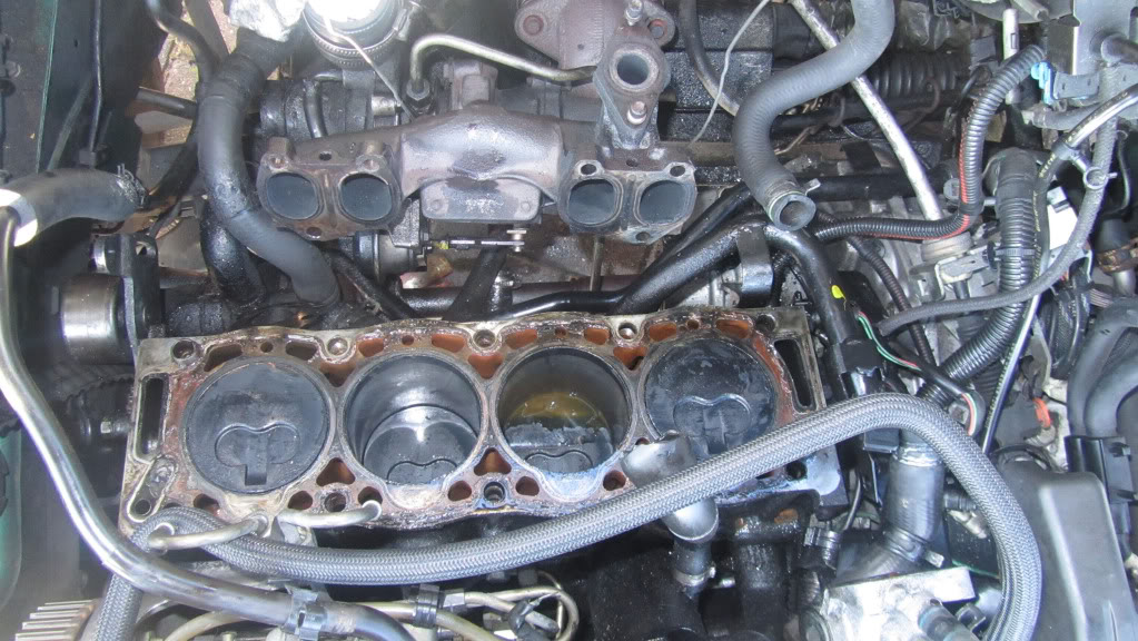

Your two jacks idea worked ok this weekend. I placed one of the jacks at the rear of the engine where Cylinder2 exhaust port would be and one jack by the AC compressor. With the offside front mount removed and gently raising it I was able to remove the inlet manifold, just about!. WIth another half days effort I was then greeted by this sight of Cylinder Head out. One of these days I will get to grips with uploading images properly.

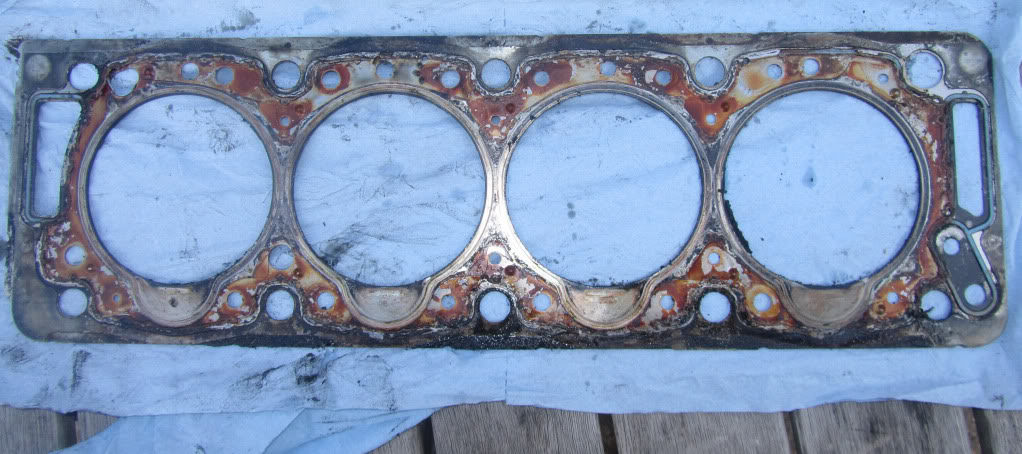

With the head and gasket on the bench I was surprised to see that the gasket was intact no break for oil to leak
To my novice eyes even the closeup view shows nothing wrong with the gasket

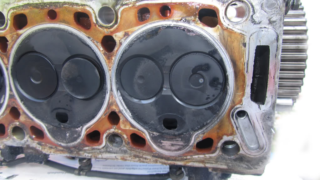

or the Cylinder head

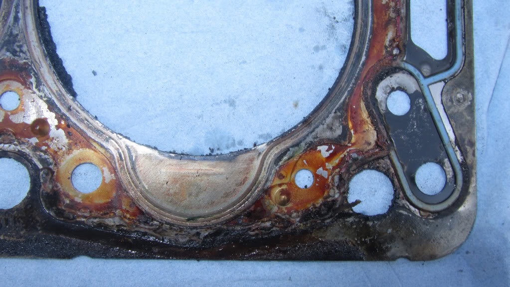

or even the closeup view of the the area where I thought it could have leaked from, i.e cam sprocket corner

I think you'll find the gasket will look OK on inspection. What actually happens, I believe, is that oil leaks between the laminations of the gasket and that's hard to see when you look at the gasket. There's a lot of oil pressure there and it only takes a little delamination of the gasket to cause a leak.
The head looks good but I'd be tempted to get a very light skim done on it just to clean it up and remove the very light impressions of the old gasket fire rings. Also, it's not a bad idea to have the skimmer give it a pressure test at the same time. He'll most likely give it a wash and it'll return looking brand new. Normally they don't even as to have the valves removed...
