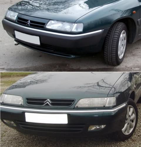

flashgit wrote:... visually they appear similar to me!
They look like each other but there are some differences :)
S1 (top) and S2:
I used pictures from wikipedia (http://en.wikipedia.org/wiki/Citroen_Xantia)

Very early S1s (93/94) had the chevrons on the bonnet rather than the grill too.

Unread post by citroenxm »
S2: Better headlight output,
VERY usefull storage bins located in the door pocket under the door handle lower part,
NO Kepypad immobilser, were you need to enter the bloody code everytime to start the car,
RF Locking, so you DO NOT need to point the Fob accuratly to lock the car, on
SX upwards cars, auto wipers, and CD Changer in the boot plus boot spoiler...
Longer oil service intervals, though this is not always a better thing too...
