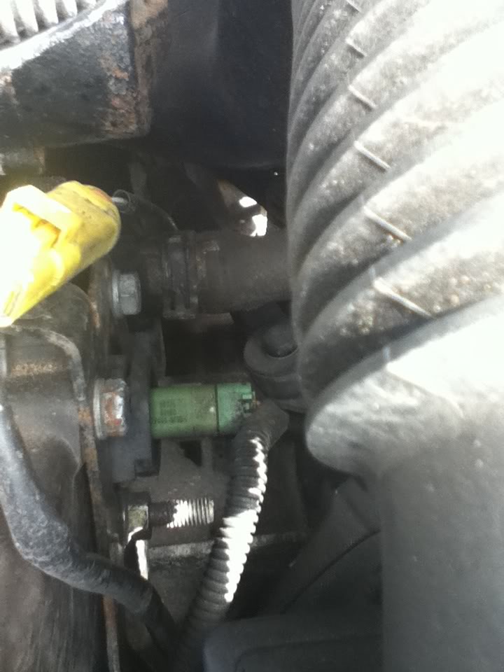

What does the temp sensor look like?

Finally found some time to look at the cars.
On both the Xsara and C5 the temperature sender is on the right of the engine if you're standing in front of it (the manual says the left side of the engine but that's because right an left are defined as being relative to standing behind a vehicle).
If you look at where the big plastic box that houses the air filter sits there's a gap between it and the engine. Look down and you'll see a threaded stud coming out pointing rightwards and just below that is the temp sender. The electrical connector plug is colour coded green.
Haynes suggests taking the battery out to make access easier but looking at it I would think that taking the air filter housing out will be more useful.

That's it.
Bear in mind I haven't actually dome the temp sender on either the Xsara or C5 but it should be similar in technique to the VW Polo I mentioned above.
I would practice on your "spare" C5 first and you'll soon see whether you need to take the air filter housing and/or battery to get at it.
Assuming you've got to actual sender detach the plastic connector. It may have a locking acion - I don't know. Then find the clip holding the sender in place. It may be a wire type or a flat piece of metal but it should be in general a sort of C shape. Once pulled out then the sender should wiggle out. There's almost certainly a rubber seal as well.
That's about all I can tell you. If I were doing the job I would work a lot of it out as I went along - which is absolutely no help to you!
