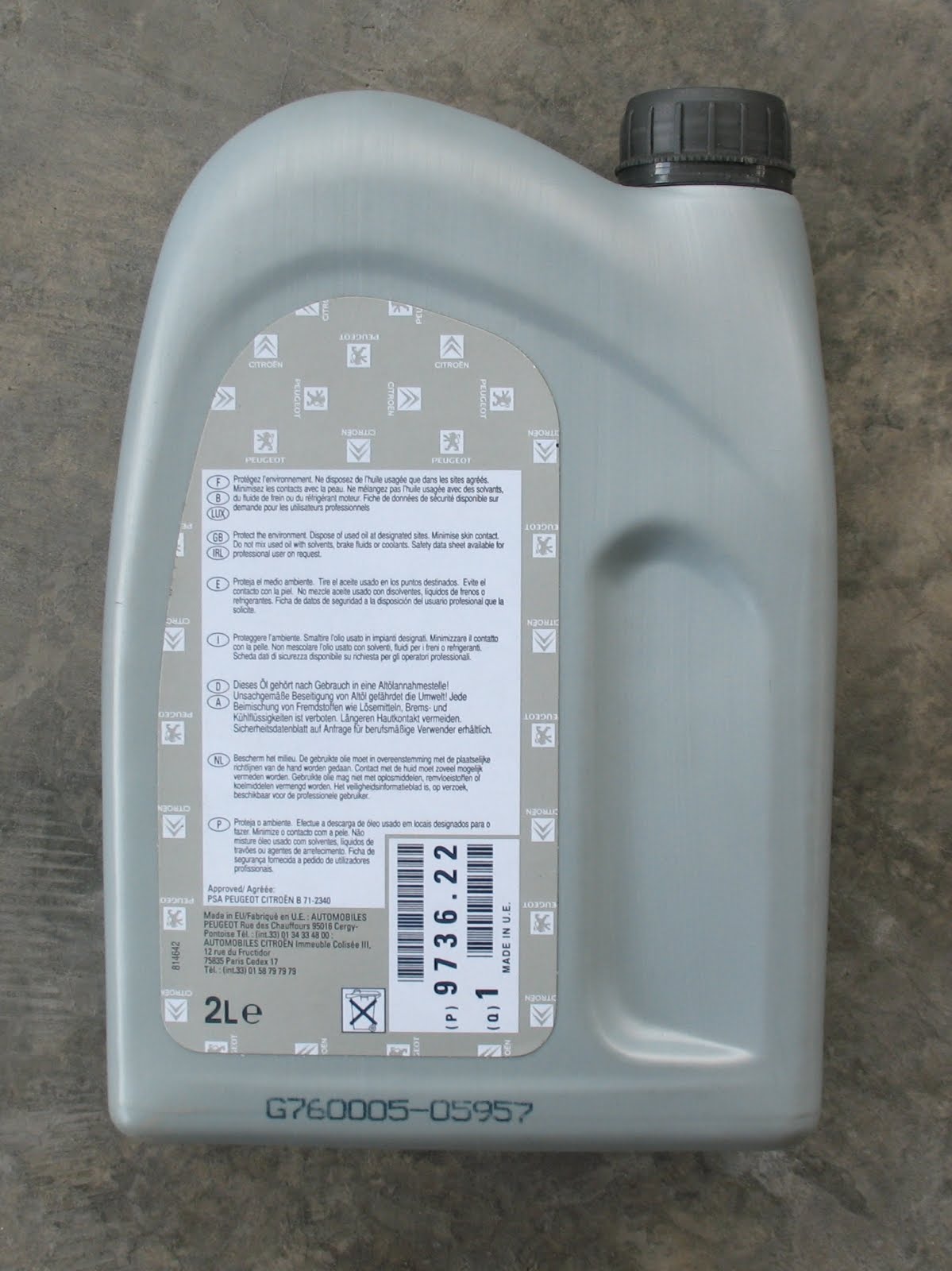

Sid_the_Squid
- Posts: 590
- Joined: 21 Apr 2009, 15:35
- x 2
As echoing everyones comments so far only use the Genuine stuff, saving £10~20 now will cost you £1000+ down the line, not worth it.
My last box oil change was July 2010, at the time the main Citroen dealer only sold in 2 liter tubs, you need 4 liters.
For a 4HP20 you will get out about 3.8 liters of oil, so put in about 3.8 liters of oil.
The oil used to look like this.. it may have changed box as its now being sold under another brand Mobil?? But its defiantly golden, and stinks..
You can see the part number on the bottle, best to use this, as some dealers really talk sh*t, Citroen Hatfield understood straight away what I wanted, but Citroen Hemel tried to sell me Dexron 3 twice... grrr.
