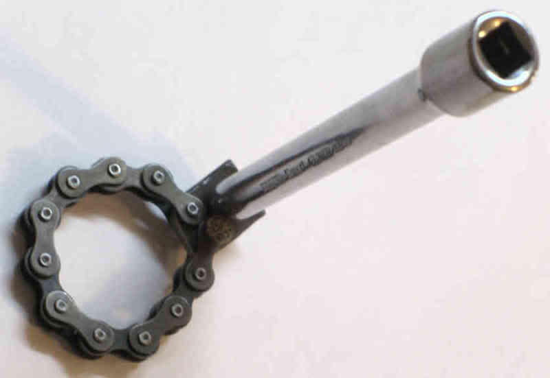

I think I posted this before.
I made up a tool as shown in the photos which allows the inner track rod joints to be unscrewed and refitted in place. It uses 11 pitches of half inch cycle chain, and attaches to an ordinary three eights drive. The actuator part shown was made of black mild steel, but it really needs to be something stronger such as gauge plate. The small holes for the chain are as close together as possible, and there needs to be a removable pin which should be on the lower tension trailing side when using (therefore reverse before using to tighten).
To use it, just assemble round the track rod, and using a long socket extension, offer it up over the inner joint. Then manipulate it till it grips, and unscrew. You can see that the one illustrated was made in a hurry, but it allowed replacement of several joints before it eventually broke. The cycle chain seems plenty strong enough, so gauge plate, or a disk turned off a socket then shaped, should be satisfactory for the actuator.

Ok did both track rods (and ends) on the Xantia at the weekend. £36 for the lot at my local factors (those guys are great). In the end I just removed the lower wishbones and turned the steering to full lock. Having pulled back the gaitor I could easily get in with some 10" mole grips and unscrew the steering knuckle. Under 2 hours for the whole job, both sides, glad I didn't splash out on the special tool now.
